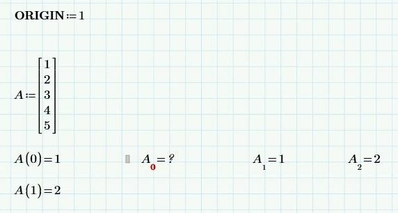

ORIGIN:=1 never works for me
Hello PTC Mathcad Community:
The ORIGIN:=1 command never works correctly for me.
See attached. I run Mathcad Prime 10.0.1.0.
If you have a suggestion to fix this, please advise.

Hi
Use the [ key (left square bracket) to get a subscripted index into A.
A[0  will get an error
A[1 will get you the first indexed element with ORIGIN set 1.

Terry, that works. I appreciate the speedy response.

The fact that Prime allows you to access elements of a matrix with the syntax of a function call was not a particularly happy decision.
But I would almost call it a bug that this type of access does not respect the value of ORIGIN.
