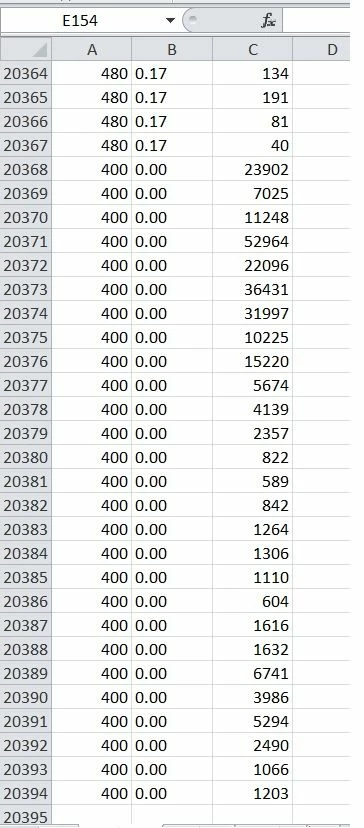

All data must be on the right. Something is wrong with the central column (B).

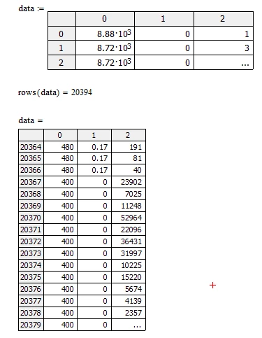

One method would be to read in the data using one of Mathcads READ.... functions.
But as you are using real Mathcad and not crappy Prime,  you can copy the data from your text file (Ctrl-C), go to Menu - Insert - Data - Table, highlight the first three columns in the first row of the data table which was just created and insert the copied data (Ctrl-V).
It should work without highlighting the top three cells but it doesn't for me.
I attach a worksheet with the inserted data.

@Francesco:
No, nothing wrong with the data. Its just your European installation of Excel which expects a comma as decimal separator rather than the decimal point provided in the text file. So the data 0.17 is interpreted as text by your Excel and not as a number and so it not right-, but left-justified.

In case you are unsure as to how to read in the data - with the data format you provided you can simply use READPRN to do so:
ebelmonte1-VisitorAuthor
March 15, 2018
Dear Werner,
It works, thanks a lot.
Mathcad is still consuming much memory 1.5Gb but I get no error message anymore.
