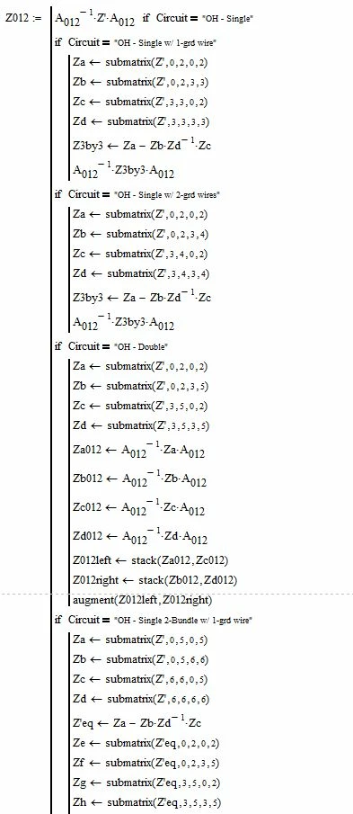

I have many "if" statements as shown attached below. Do these affect the memory? Each "if" statement does different calculations using matrices. Z' can go up to a 14x14 matrix.
August 6, 2019
a couple of 14 x 14 matrices sure should not lead into a memory problem.
I don't think that the if statements should affect memory usage.
Just by habit and for a small performance improvement I would use explicit "return" statements at the end of each if-branch to avoid unnecessarily  checking the following conditions.
It may also help saving memory during the calculation if you don't assign too many local variables but use the expression directly in your calculations (at the cost of losing readability and clearness). But the matrices you use are so small that memory sure should not be a problem, so I suspect the reason has to be something else.
You may try to turn the calculation into a function by writing
doIt(dummy):=<your program for Z012 here> and then use Z012:=doIt(0)
Instead of dummy you may use some or all of the involved matrices as arguments, but I suspect this could mean increased memory needs.
It may help if you make Z' the function argument - give it a try.
Or leave it as it is and make the first line of the program Z' <- Z', turning Z' to a local variable that way. Just a shot in the dark, though.
