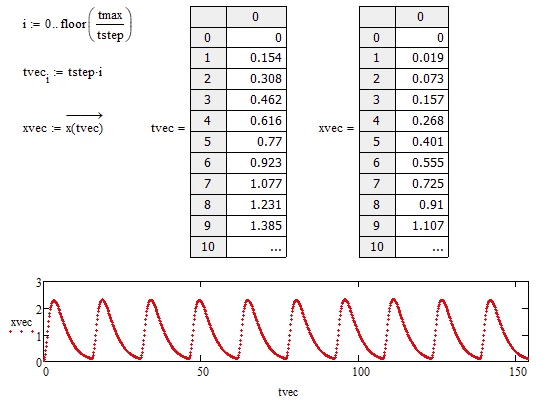

is there a way to convert the odesolve output to a matrix, so that the max and min can be found. apparently the odesolve output is a function. i attached a worksheet. i want to convert t and x to matrices.
Werner_EAnswer
How about
Of course you could use any vector "tvec" as long as its elements are all in the range from 0 to tmax. You may simply replace tstep by any other value.
How about
thanks werner,
i had been trying to use vectorize but it wasn't working for me. i'll try again. i must have been missing something.
23-Emerald I
Before there was ODEsolve there were the line solvers, (Adams, rkfixed, Rkadapt, Bulstoer, and Radau).
rkfixed et al are still there, and the output is the matrix you're looking for.
ODEsolve automated one of the line solvers and fit a curve to the points.
