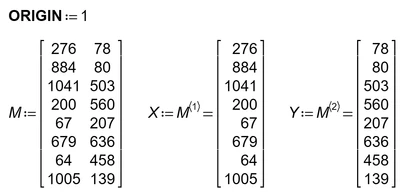

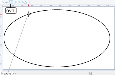

My students and me decided to check which oval Paint draws. It seems to be an ellipse. See pictures below and Prime 6 in attachment.
But there was a suspicion that these are arcs of two pairs of circles - see Oval - Wikipedia.

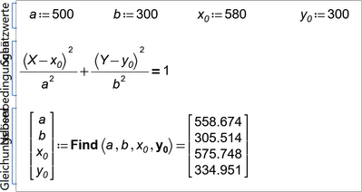

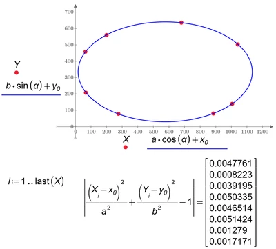

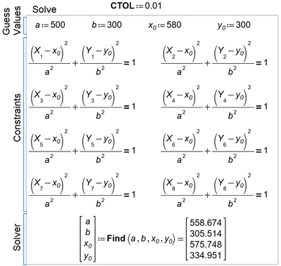

Problem. There are the coordinates of the four vertices of the "horizontal" oval. It is necessary to draw an ellipse through these points (this problem is solved) and an oval made up of arcs of two pairs of circles. What oval does Paint build? Maybe there is a third way?

Don't be afraid of using vectors in the solve block (and vectorization when making the check(!
And as its much easier to apply different vertical and horizontal scaling to a circle as opposed to calculating the approximation circle arcs, I would strongly guess that Paint is drawing an ellips and not four approximating circle arcs.
Of course actually its drawing polygons 😉
And given that it cannot create infinite thin line segments and that there is the resolution to be taken in account it actually creates some kind of komplex, filled polygons ‌.
I have used at first only 4 points and add new and new!
One more reason to use the vector equation so you simply can add values in the vectors and the rest remains untouched - no need for a cop and past orgy.
