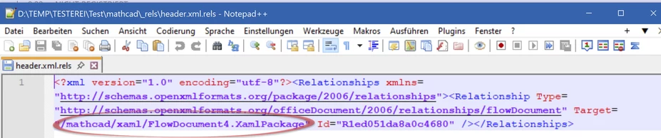

The reference to the FlowDocument#.XamlPackage containing the the text of the header resp. footer are in mathcad\_rels\header.xml resp. mathcad\_rels\footer.xml .
In the attached file test.mcdx (when renamed to *.zip) we can find in the file /mathcad/_rels/header.xml with the reference to /mathcad/xaml/FlowDocument4.Xamlpackage

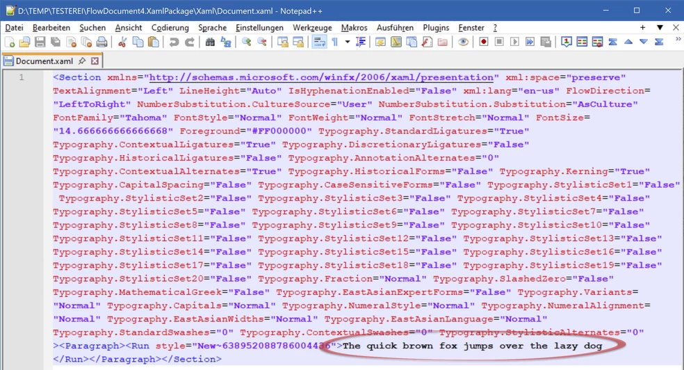

FlowDocument4.Xamlpackage is a zipped file again an when we unpack it we find in /Xaml/Document.xaml the text I used in the header

That's tricky!
When you unzip a mcdx file you should see a directory "\mathcad\xaml\". In this directory you should see a couple of files with names "FlowDocument<x>.XamlPackage", where <x> is a number. These again are renamed zip archives!
When you unzip them you should get a directory "Xaml" and the file "Document.xaml" in this directory contains the text of the header resp. footer.
I just created a small test document and here the header text was found in "FlowDocument3.XamlPckage" and the footer text in the file with #4.
The numbers 3 and 4 may vary. They are referenced in "_rels\header.xml" and "_rels\footer.xml".

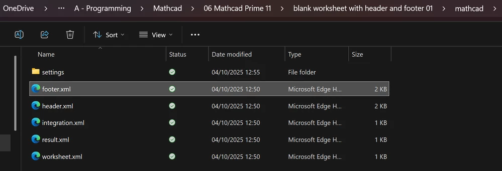

Interesting.  I've just created a Mathcad Express 11 worksheet based on the Blank template, adding only a header and footer.  The header comprises a math region and the filename.  The footer comprises a text region and the <page of pages> data.
I couldn't see the header and footer in _rels, but I did find them in mathcad.
Here are their pretty-printed contents in Notepad++.

The text region in the footer appears to be encoded.
The Mathcad Express 11 worksheet is attached.

I created a test sheet, too.
But I used just one custom text region in the header and the footer.
The text I used could not be found anywhere in header.xml or footer.xml but as described rather in the file "Document.xaml"  which is inside one of the FlowDocument#.XamlPckage.

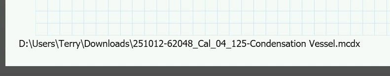

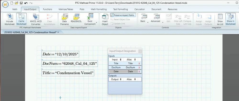

Oct 3, 2025 5:35 PM UTC
If you are prepared to open a Mathcad template then save as a file you can use the API to open the template set the values at the top of the calculation sheet rather than the header and save with an appropriate filename.
In the footer that shows on every page it is possible to put the path and filename given during save with the API that has the appropriate data in filename.
Cheers
Terry
terryhendicott
Oct 4, 2025 9:08 AM UTC
And this is the version I would save as a template with an Excel component cover page.
Cheers
Terry
