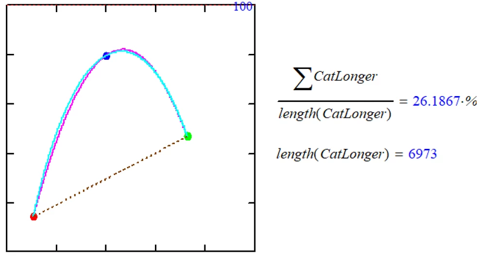

First run over 100 iterationsFirst run over 100 iterations
No, it's more towards 30 %. The next run is over 200 iterations:
And finally over 1000 iterations, but showing only 1 in 5:

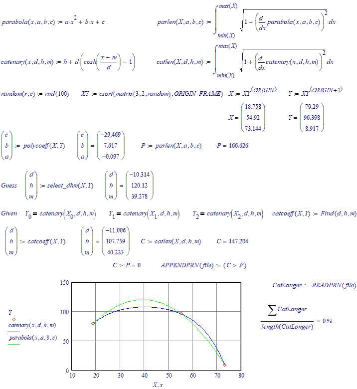

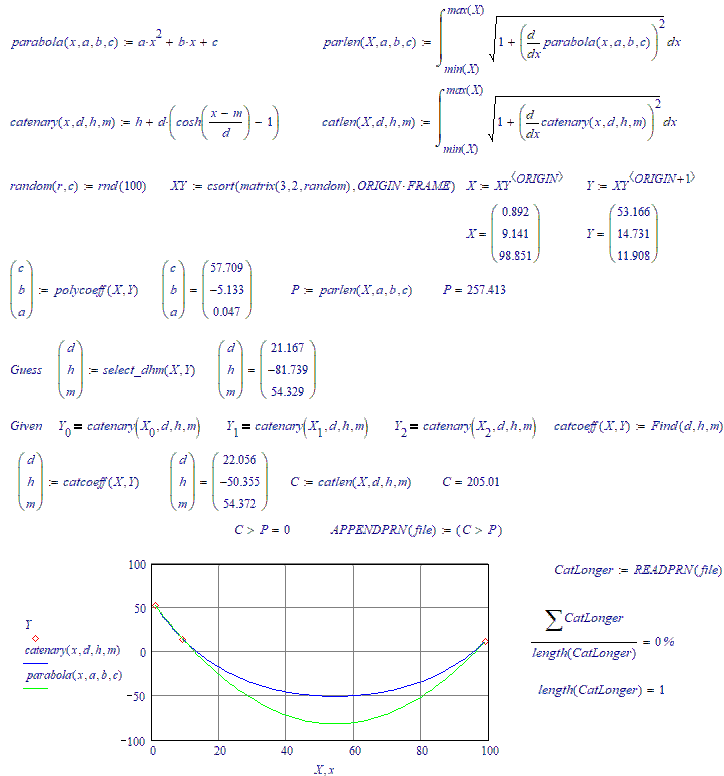

I've got a puzzle for you: try to find what my select_dhm() function is... (The function I use to provide guess values for the solve block of finding the parameters for the catenary function)

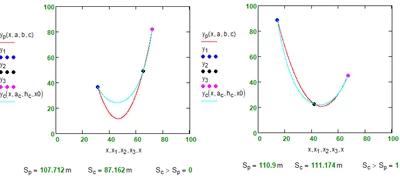

May 15, 2021
000100000100010000-0000011010000-00---110000100010000100-011001-0101101-01100000--1101--110101-010-010000101-001-010-0-0001-1-00000--0-10011101000-0-0-00-01010000-0-01-10-0001000-010100-0-00001101011100000110110111--0101-01-101010---000000001000100-000001100111000-10 (Tomorrow I will continue my research)
1 - Sc > Sp
0 - Sc < Sp
- (hiccup) - no solution
* - Sc = Sp (I am waiting for)
It's like a hiccup. You don't know when you will hiccup next time - when next time there will be no solution of the problem of catenaries and parabolas.
By the way, there is a very interesting study of the frequency and strength (- or ---) of hiccups.
May 18, 2021
Catenary longer than a parabola about (a bit more) in 26 cases out of a hundred.
May 18, 2021
With prorgramming
