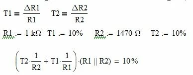

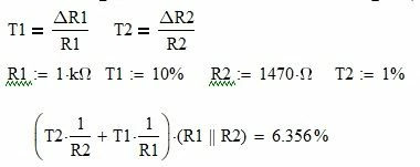

March 31, 2020
Let me point out that parallel resistors are current dividers, while series resistors are voltage dividers. To solve your problem you must first of all take into account the tolerance of each resistor, that is, if the resistances all have the same tolerance then the resultant has the same tolerance. It is not so obvious if the tolerances are different. For example for two resistors in parallel, the equivalent resistance has a tolerance equal to:
For equal tolerances:
for different tolerances:
So you could create a C ++ program that, given the values and tolerances of the resistances, calculates the equivalent resistance of the parallel and goes to search into the database for the resistor with a value that is closer to that calculated taking into account also the resulting tolerance.
The inverse process is valid if, given a resistor, you look for two whose parallel, gives the given resistor.

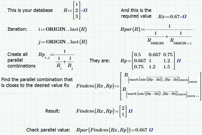

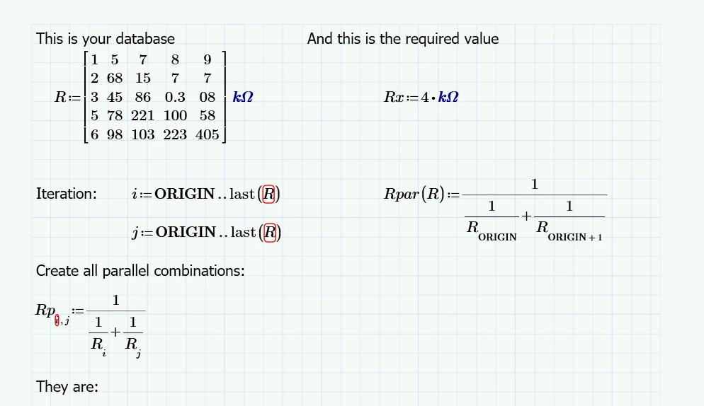

April 6, 2020
Here goes the brute force method:
Attached is Prime 4.

Artiom1-VisitorAuthor
April 6, 2020
Hi Luc,
How can I integrate more than one column of resistors in the database? Matrix does not work...R in not defined as it was a vector I suppose.

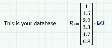

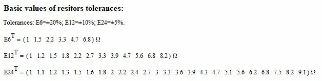

April 6, 2020
The database should respect the EIA standard values of the resistors, the most common are shown here:
so that yours database could be (for example resistors in  kΩ):

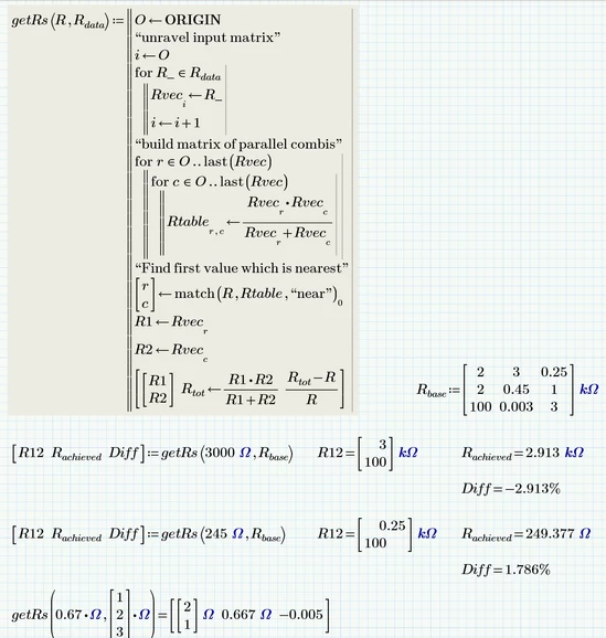

April 6, 2020
Here is my version of the brute force attack I had in mind in my first answer.
Its an all-in-one routine and it calculates the table of possible achievable values every time it is called. I guess that, as long as your data table of resistance values is not really huge, this should be no performance problem. Otherwise you may change the function so its second argument is an already precalculated table.
The function also returns the value actually achieved and the relative difference - change as you need.
The function will also work with matrix of possible resistance values but I see no reason why you shouldn't use a simple vector.
Prime 4 worksheet attached
