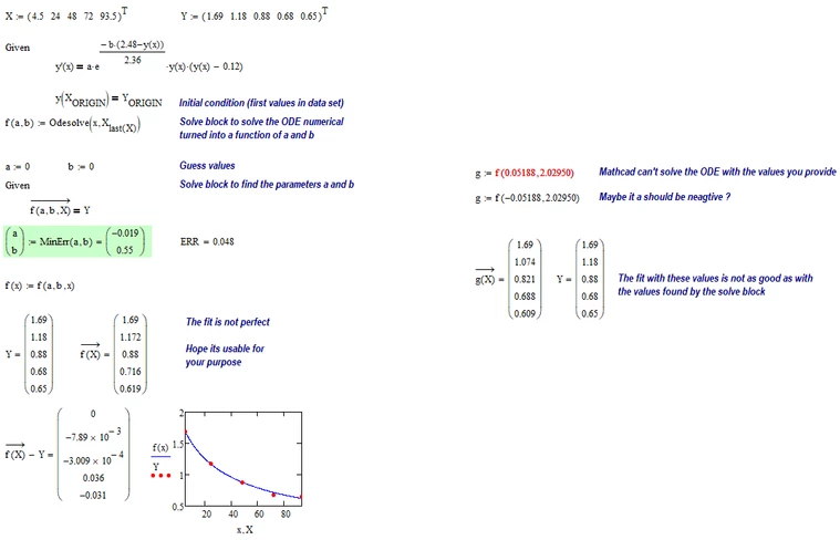

I have a set of experimental data and a differential equation with two coefficients inside it.
I am trying to find these two coefficients using regression and by solving the equation.

Here is a way how to do it:
Using the values for a and b you give as solutions makes the solve block fail (does not converge)!?
Mathcad 15 Worksheet attached

Thanks Werner,
It helped me a lot.
