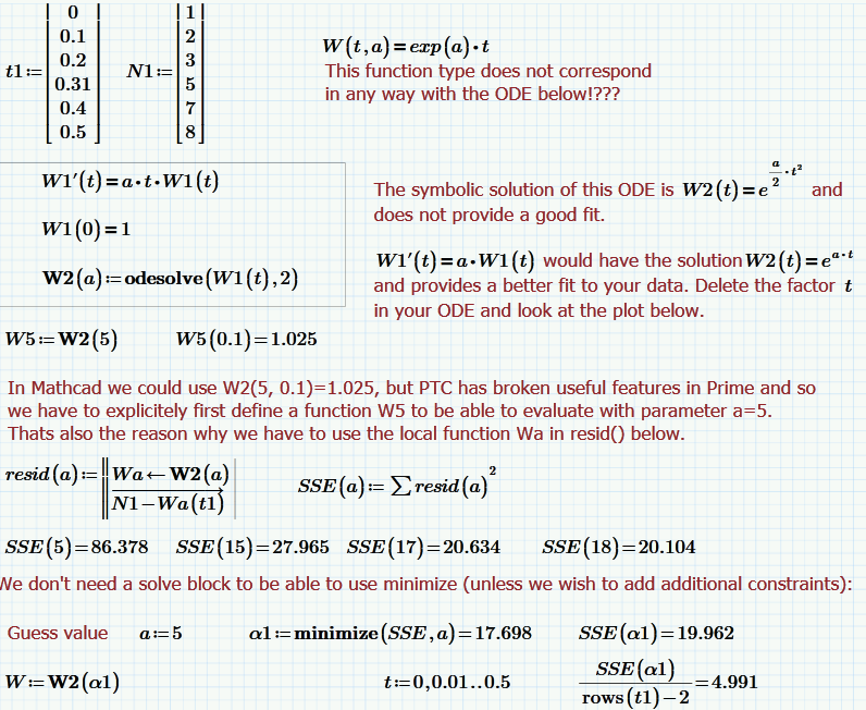

Parametrize Odesolve and define constants by least sqeare

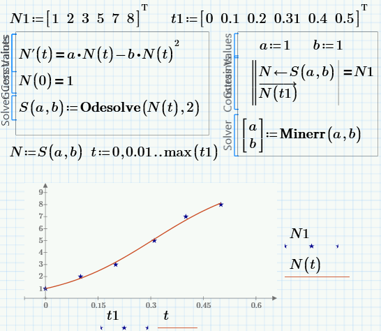

Hello everyone, I am going to parametrize solving block (odesolve func) and then define corresponding coefficients by least square.  But unfortunately, I meet problem after parametrization of the solve block. Could someone help me with this? Thank you in advance. You can find example of the program attached
33 replies

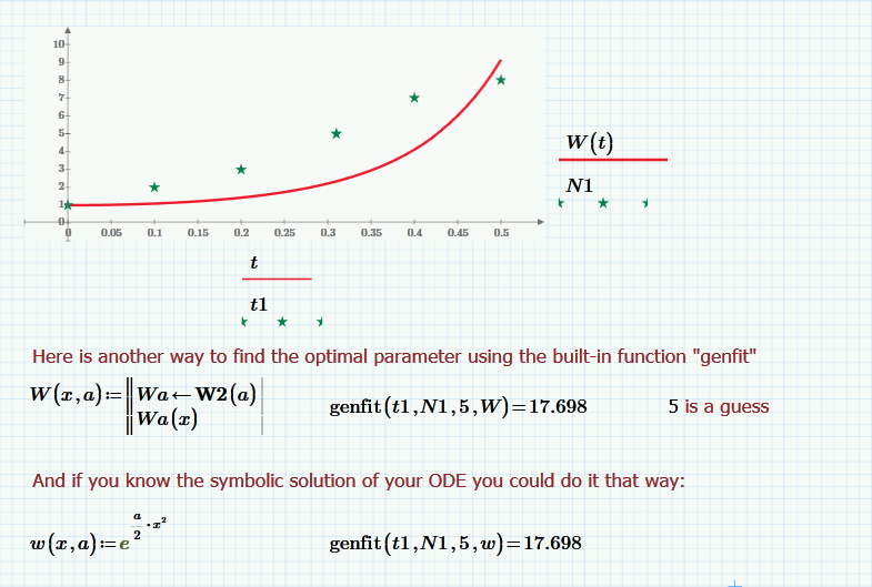

Hope that the attached will help.
At the end of the attached file you also find a way to use a solve block with "minerr" to get the optimal value for a.
What about this:
Viktor
Thank you very much, it works geat. The last question is about few differential equations. I need to solve a system of diff equations but fit them by the data for only one of the main variables.  For example:

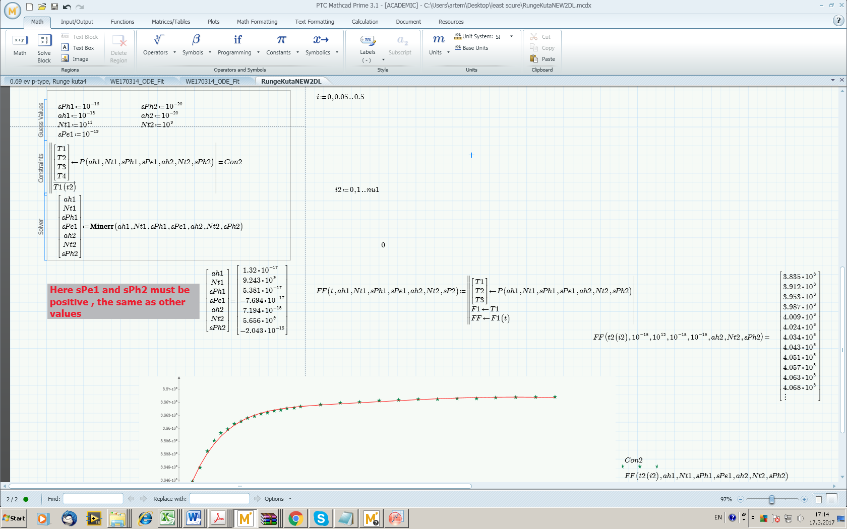

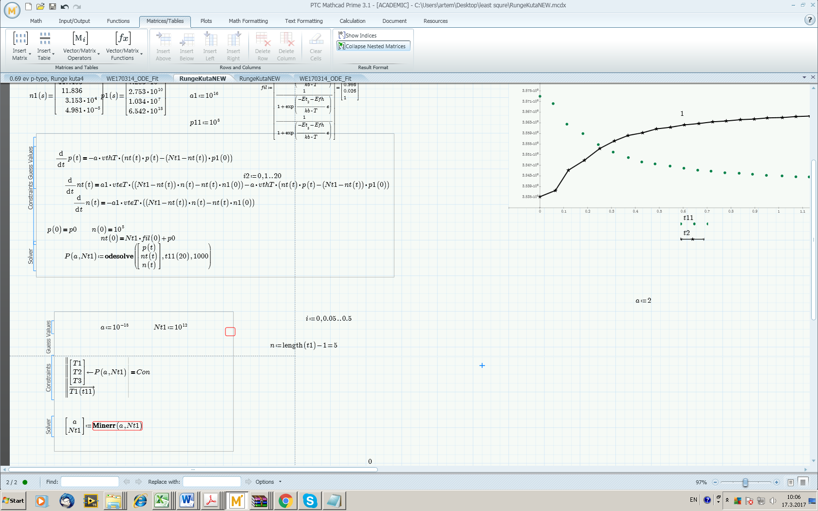

Hello everyone,

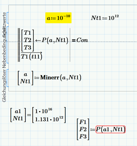

I am trying to find parameters of the set of differential equations. So, I solve st of dif equations by Odesolve (see attacehed) and then trying to minner coefficients a and Nt1 using experimental data Con and t11.  The system must at least work, but I have error at Minerr step. Could someone help me with this? Thank you, very much.
Obviously the guess values are at a magnitude which makes the odesolve block fail.
Changing the guess for a in the minerr block makes the block  work, but the odesolveblock fails using those values:
Thank  you, it works now. I went further and meet the next problem.
Minerr function calculates coefficients , but they are negetive some time. How can I give additional condition where all the coefficients must be a positive value. Sorry for obstruction, it look like the last problem which I need to solve.

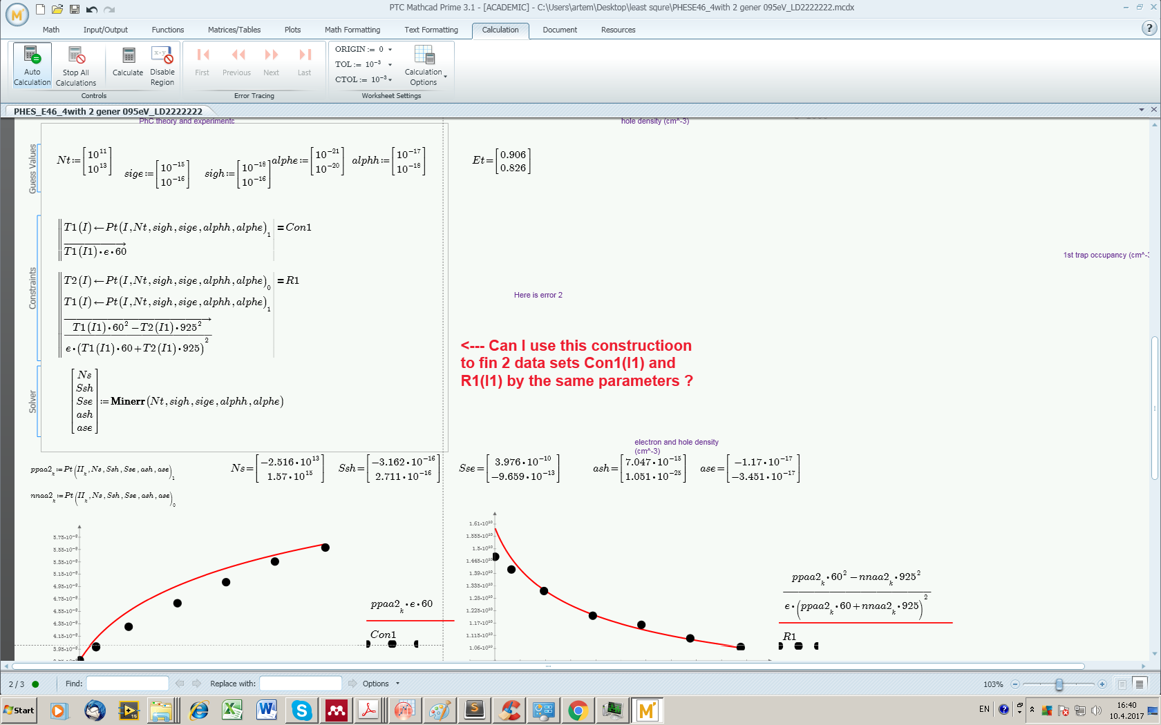

Hello everyone,
Can I use the following (see attached) consistent Equality conditions constructions to fin 2 data sets Con1(I1) and R1(I1) by the same parameters.
I am solve set of equations and get n(I1) and p(I1) , so then I compare p(I1)*e*60=Con1(I1) and (p(I1)*60^2-n(I1)*925^2)/e*(p(I1)*60+n(I1)*925)^2 = R1.
I found out that if I delete the firstEquality condition fit does not change. So this can mean that I use wrong Mathcad syntax. Unfortunately, I did not find some similar programs.
Can someone experienceexampl.png with this?
