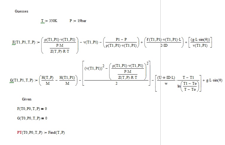

question.jpgHi All,
I want to use a parametrized solve block in a programing loop. The problem is that the solve block gives two output with two units, pressure and tempreature; so I cannot assign it to a function.
I appreciate any hints.
Thanks in advance.

You have to define two functions:
RichardJ19-TanzaniteAnswer
September 14, 2016
September 14, 2016
One partial solution
23-Emerald I
September 14, 2016
Divide by the unit (you can use "UnitsOf()" to stay consistent in the solve block, then two separate functions after to access the correct unit values.
