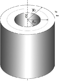

I am trying to solve one dimensional heat conduction in a hollow cylinder (for example a pipe) with heat convection both from the inside and outside.

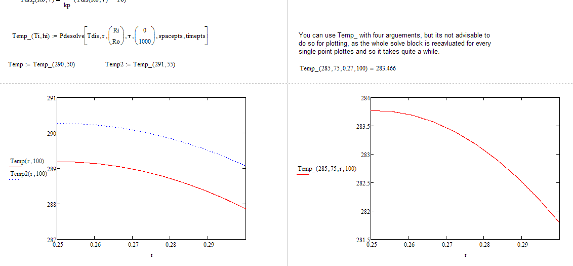

Is there a way to use parametrized solve block with pdesolve? I want to be able to use the solve block for different values of Ti and hi, in a for-loop.

Yes, there is a way and fortunately is easy and straightforward:
Werner_E25-Diamond IAnswer
npouladi1-VisitorAuthor
Great help, thank you very much 🙂
