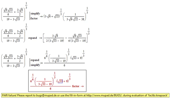

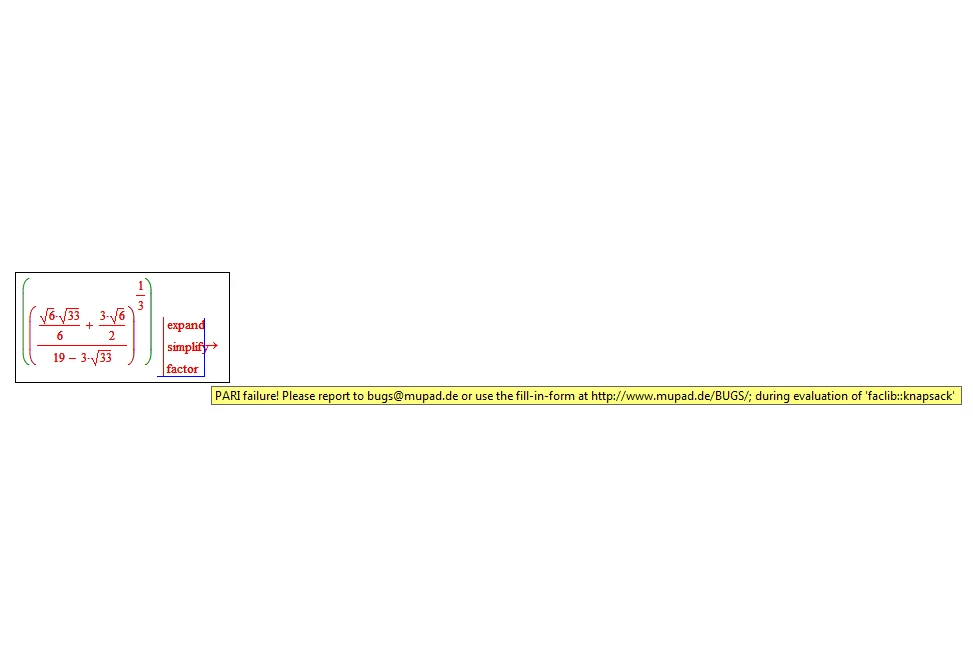

"PARI failure!" What does that mean ?
Hello Everyone.
From :
To : "PARI failure!" What does that mean ? ( MC15 )
Thanks in advance for your time and help.
Best Regards.
Loi

It means that you have found a way to trigger the error detection mechanism in the symbolic processor (mupad) of your Mathcad 15.

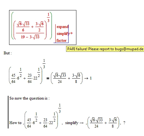

If you are curious about the answer to your expression (Mathcad 11/Maple):
I find the simple answer of factor better:
Many thanks, Luc.
But I'm curious about the answer to my expression of (Mathcad 11/Maple):

You sure already found out that its the last modifier ("factor") which throws that error:
Would be interested to see how the current muPad (owned by MathWorks now, makers of MatLab) deals with this expression.
However, I am very surprised and wonder where you still get this unbridled confidence that Mathcad could actually be able to simplify your expressions in the desired way. 🙂

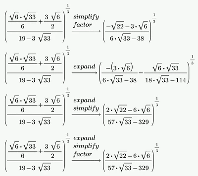

Here are the result of Prime 10 (symbolic processor is freeCAS/Axiom)
