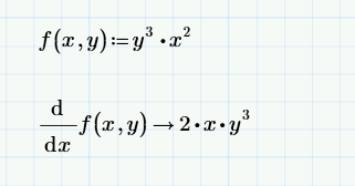

Jul 23, 2014 12:23 PM UTC
In Prime 3.0, you can use the regular derivative symbol to accomplish a partial derivative. The notation will obviously be different, but the function will be the same. 7-23-2014+8-18-59+AM.png

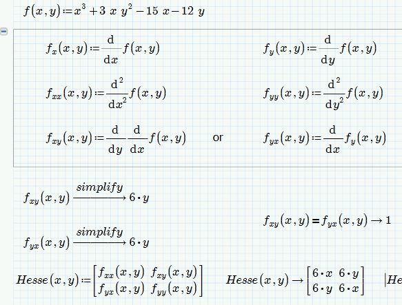

Technically there is no difference between the partial and the regular derivative. But its annoying we cannot show the symbol the correct way in Prime as we were able to do up to Mathcad 15.
Depending on what you want to achieve you may chose to define some auxiliary functions (collapsed area) to simulate another way to denote partial derivatives.
