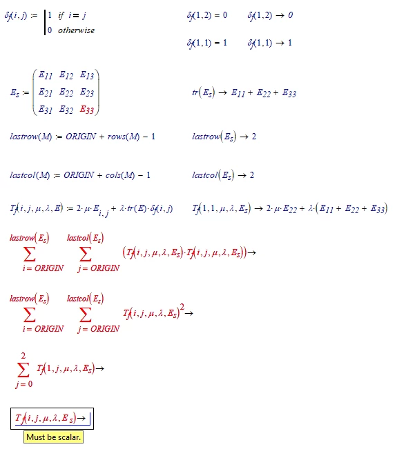

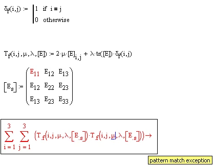

I`m trying to make simple calculation but without success. What`s the problem?
MC15 file is attached for convenience.
Thanks in advance.

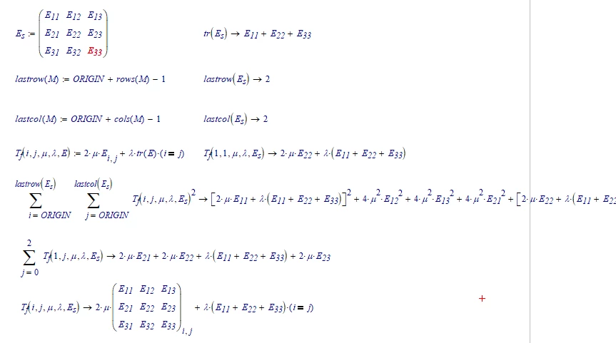

Or use this alternative definition of it:
(The symbolic processor is not so fond of programming constructs, it likes pure mathematical expressions better.)

I get this in Mathcad 11.
(The error messages are the same for all red evaluations).
Apparently it's not 'simple'.

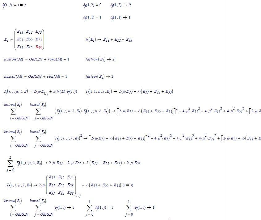

Problem is in delta function, if you change it by 1 for example everything is OK.
If you change double sum by two summing loops inside program block everything is OK too!See attached file
November 1, 2017
Then don't use the delta function, but use (i=j) instead:
