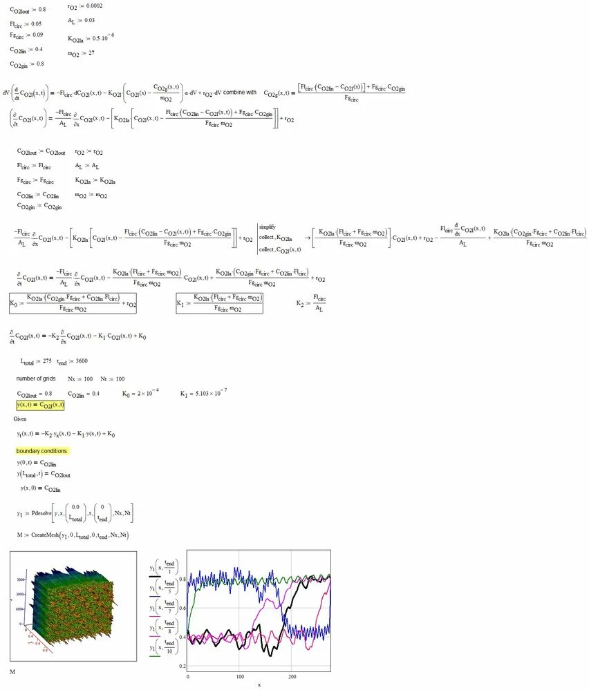

it is better to simplify everything......The following  solution isn't tested:

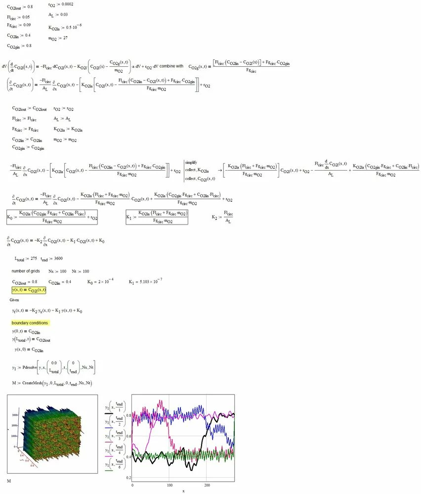

Hi SavitriN,
the following is a revised and corrected solution.
SavitriN1-VisitorAuthor
October 29, 2018
Thank you very much!
I will try that 🙂

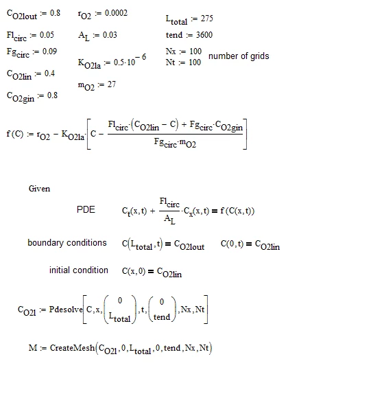

October 27, 2018
Here's my simplified solution:
Alan
October 29, 2018
Thank you for the response.
Yes i will try this solution as well.
