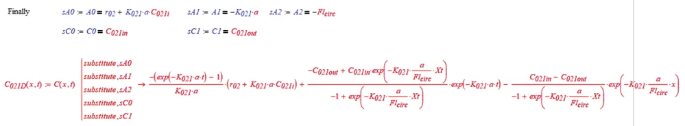

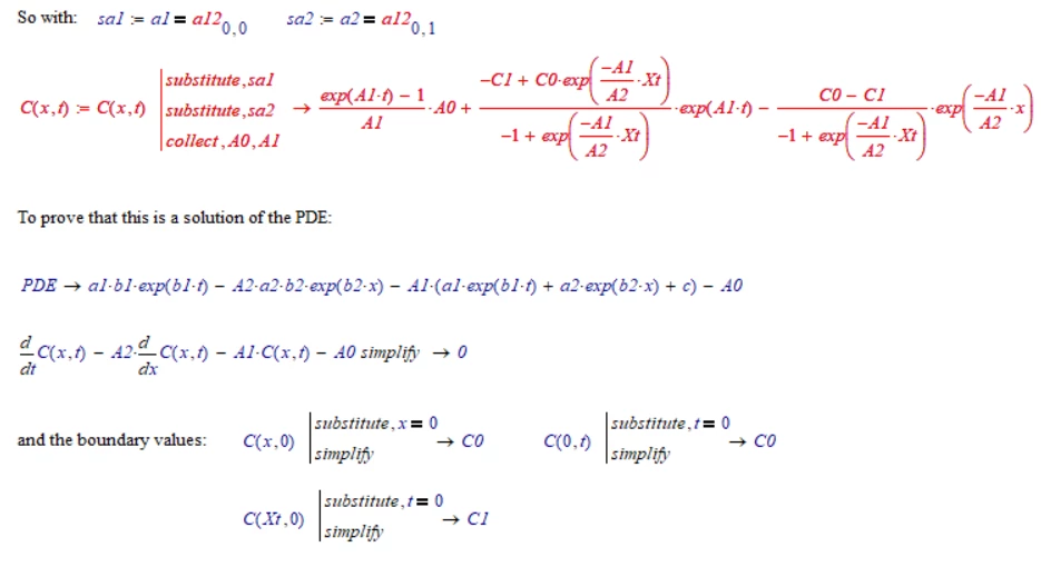

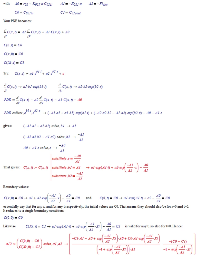

23-Emerald V
October 1, 2018
Maybe this helps:

October 1, 2018
Hi SavitriN,
The way you set up the problem, it seems that you want a numerical solution. If so, all the values of the known terms, the initial and the boundary conditions are missing.
23-Emerald V
October 1, 2018
Once these values are supplied, the numerical solution can be obtained with pdesolve, and compared to the symbolic solution...
