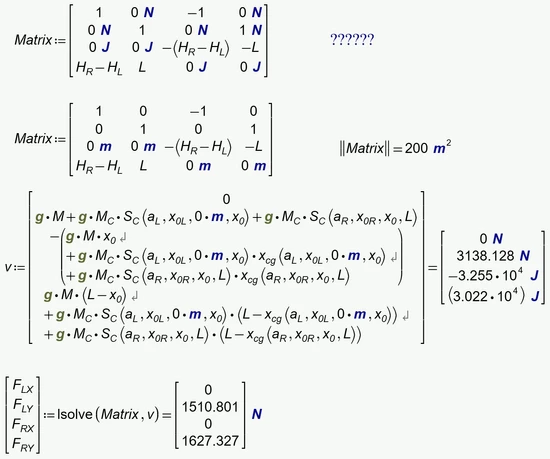

Obviously a unit mismatch, as the error message says:
Are you sure about the units you applied to the constants in your matrix?
Thanks. I know it.
The questiob is why we have not correct solution with the Find and the lsolve function?
Is the system of equation wrong?

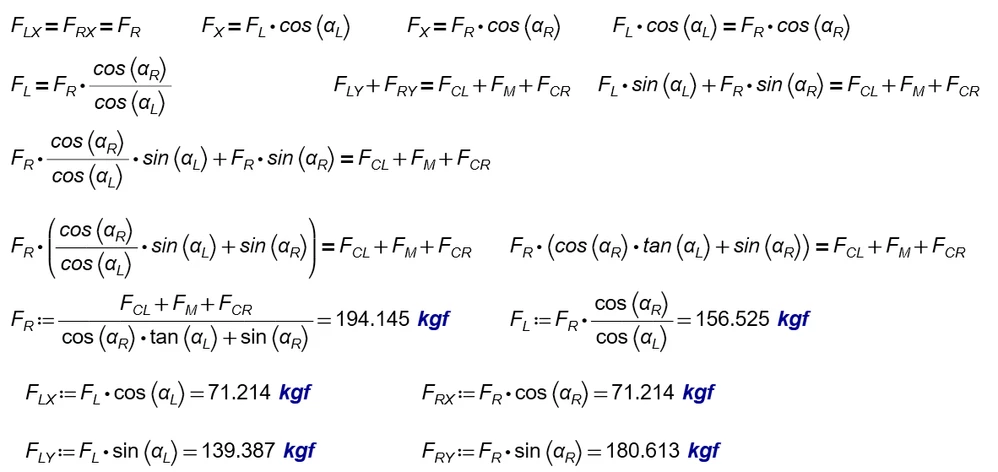

The correct direct solution:
