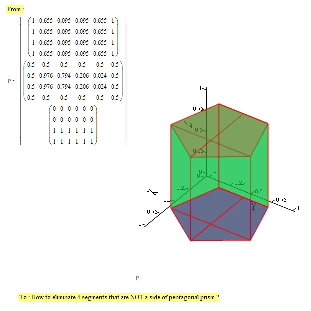

Pentagonal Prism and Elimination Segments ?

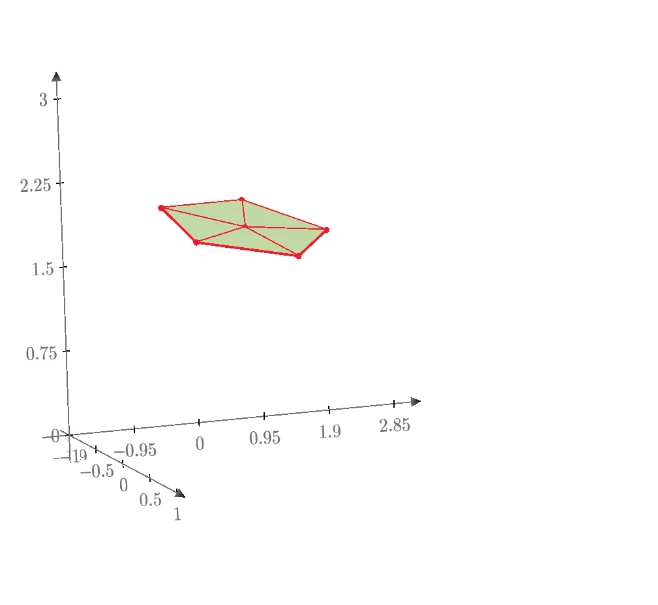

Hello Everyone.
From :
To : How to eliminate 4 segments that are NOT a side of pentagonal prism ?
Thanks in advance for your time and help.

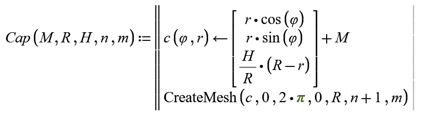

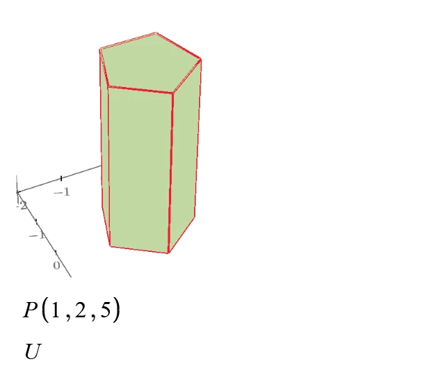

This is by Werner_E.
With cap.

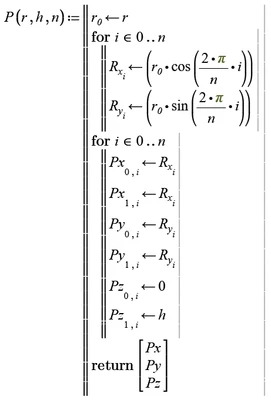

ttokoro
November 14, 2020
t.t.

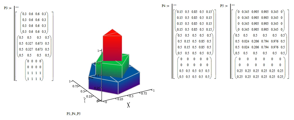

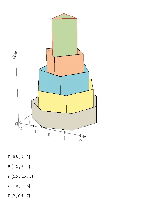

Thanks for your hints, Ttokoro.
( Ttokoro, your hints should attach with an output. Because of might be followed with MathCad 15. )
