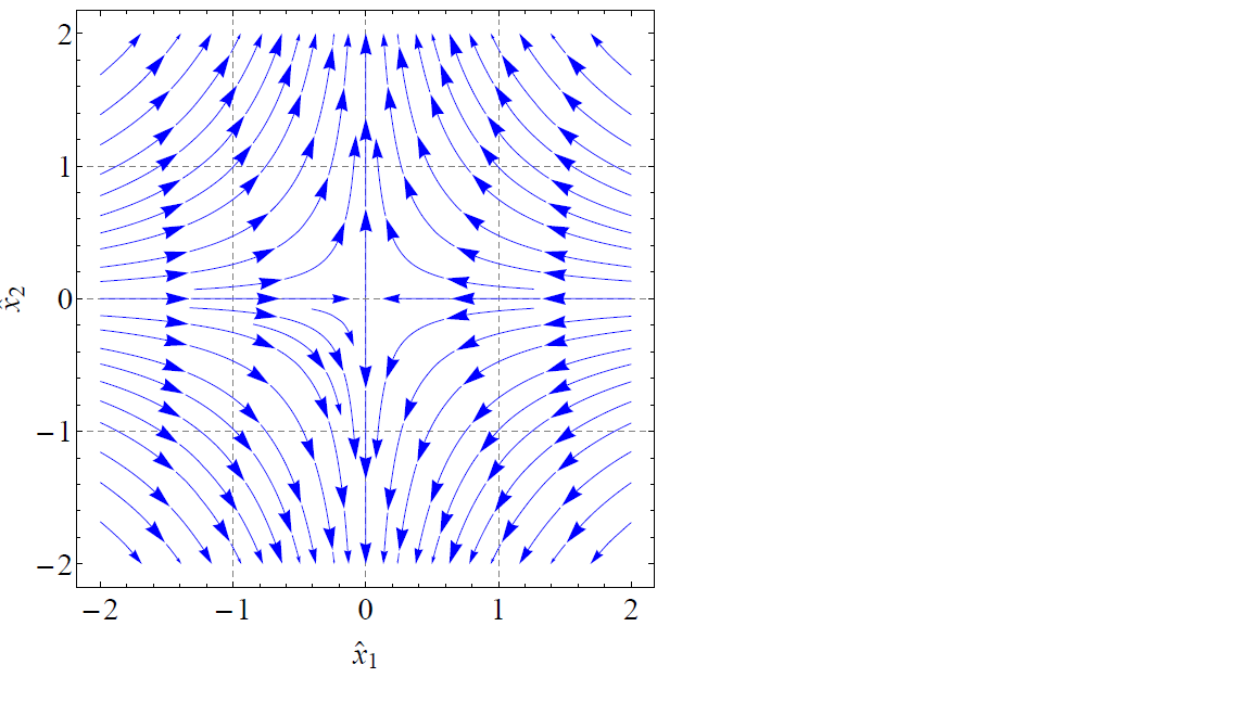

Hi all,
I know we have lots of smart users out there.
Please help with drawing Phase Plane Plots. Or Trajectory Plots.
Something like this: Any Help is appreciated.

Here's a worksheet from Tom Gutman, which draws vectors. You should be able to extend this easily enough to draw curves with arrow heads by just adding more segments to the lines. Or you could just show the trajectory as a lot of short vectors.

Mathcad 15 can draw vector field plots. I used that successfully long ago to map magnetic fields.

Thanks for the hints.
I was hoping that there was some easy function withing PTC Prime 2.0 that I could use to draw these.
As I got these using Mathematica.
I like how Prime 2.0 can do 3D plots very easily. Hopefully, in the future, I can get the phase plane plots also.
