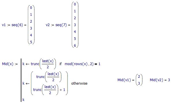

Something like the built-in function median or something like the "half max index" as shown below?
Note that the value returned by median is not necessarily a number present in the vector but sometimes its the average of the two center values (when the vector is sorted).

An alternative for the condition when you have even members.
Mike

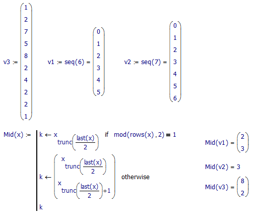

September 11, 2015
Careful! Your routine just returns the index of the elements, not the vector elements themselves.
September 11, 2015
Well spotted Werner
Mike
