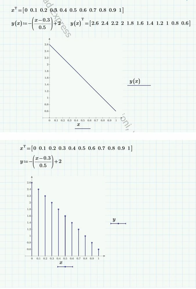

Hello!
I am trying to plot the picewise function (attached).
Do I need to use "if" statement here or are there any other options?
I think that it should be something like this: if 0<x<0.3 then y=2, if 0.3<x<0.8 then y=-((x-0.3)/0.5)+2, if 0.8<x<1 then y=1.
Would anybody, please, help me with this issue?
Best regards,
Sergey

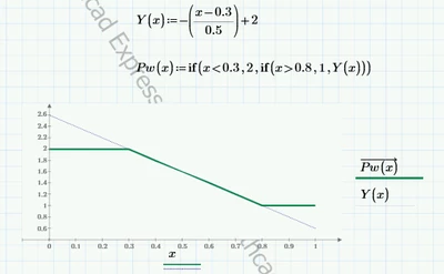

Werner_EAnswer
May 5, 2020 11:52 PM UTC
You have already been shown the variant using the if-function and also the variant using the Heaviside step function. Both look a little confusing in my opinion. The only advantage of the Heaviside variant is that you can apply symbolic operation (e.g. derivative or integral) to it.
For completeness sake here is the variant using the programmed if-statement:
BTW, there is no need to define any vectors for x and y. Just plot the function and set the axis limits directly at the axis labeling (you can change the first, second and last value). I set the lowest value on the x-axis to 0.1 to match the picture and also dragged the y-axis to the right accordingly.
P6-worksheet attached

May 5, 2020 1:26 PM UTC
Sergey15-MoonstoneAuthor
May 5, 2020 1:28 PM UTC
Thank you.
But how do I get y=1 and y=2 in the same graph?
Sergey

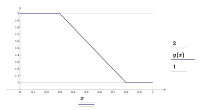

23-Emerald V
May 5, 2020 4:02 PM UTC
Just add them.

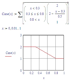

The if statement is  one good way.  You can also use Boolean comparison multipliers.

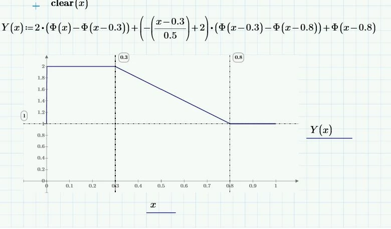

May 5, 2020 6:00 PM UTC
To draw the graph, you can use the step function as shown here:
Werner_E25-Diamond IAnswer
