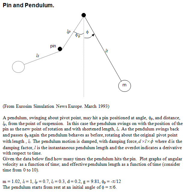

Here's a problem I came across years ago. How many times does the damped pendulum hit the pin? Work it out using Mathcad or look at the video I'm about to upload and just count!

Fine!
But two question:
1. How many touches - 3 or 4?
2. Where is the file?
