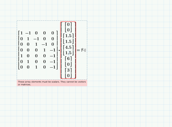

Damdinsvren Bayasgalan wrote:
I think you may need the C vectors in row form rather than column form to make the matrices conformable. The way you have implemented it, C is a nested array rather than a matrix.  Perhaps this is nearer what you want? ...

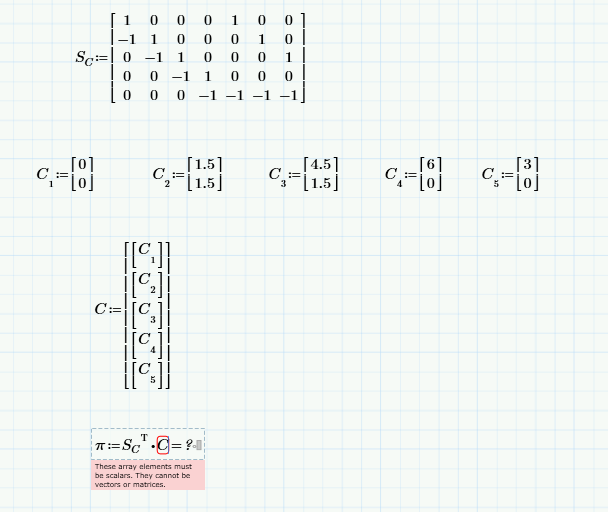

April 12, 2016
April 12, 2016
The way you have defined C, it is a vector of vectors. You cannot use such a structure in normal matrix math. If what Stuart shows is not what you want, please explain, in words, what you are trying to do.
