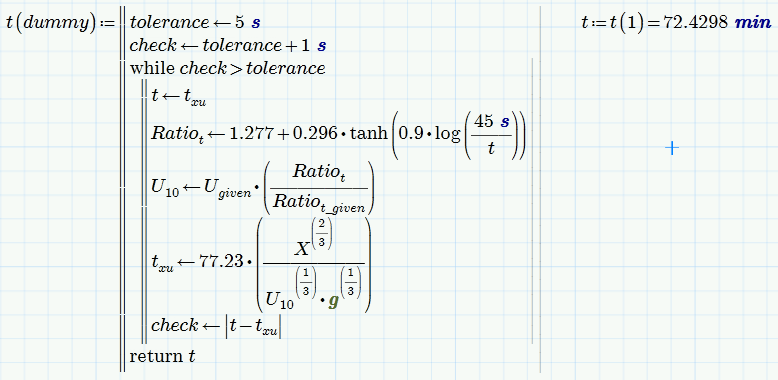

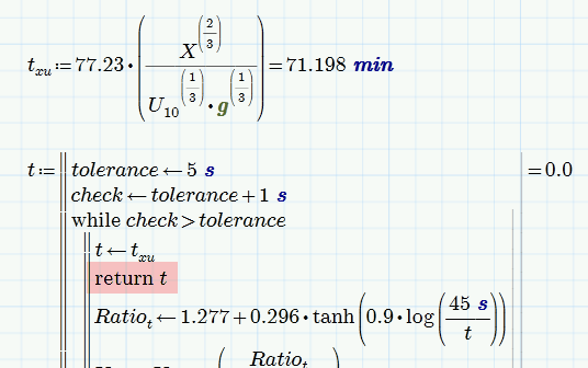

I am using Prime 3.0 and I get the division by zero error no matter if I recalc or rename t.
Its clearly a bug and I think we already had a thread about it quite some time ago.
As far as I recall Stuart and Luc are using Prime 3.1, so chances are that the bug is already fixed.
When you open a Prime file no recalculation is done but you see the result of the last calculation done before saving the file.
So when you open the file, you saw what Dustin saw in his older version of Mathcad.

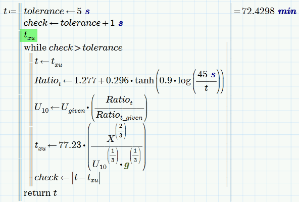

Inside the while loop the global variable t.zu seems to be treated as a fresh local variable being zero:
Crazy enough, simply using/mentioning t.zu in any way before the loop cures the problem:
Turning the routine into a (dummy) function also works:
Given the answers of Stuart and Luc it really looks like its a bug present in Prime 3.0 (and below ?) which was fixed in Prime 3.1.

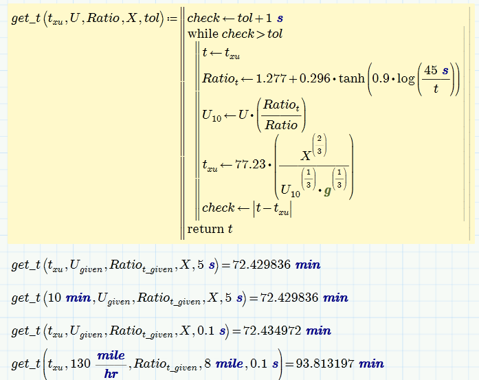

Nevertheless I feel that its better to make a program self-contained and not relying on global variables.
So I guess that I would turn the calculation into a function with all the necessary values as arguments:
EDIT: You should return t.xu, not t. That way gaining one more iteration.
