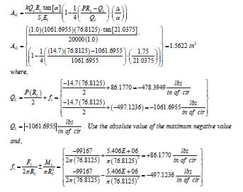

Please solve the calculation
Kindly solve the problem as per meow manual calc

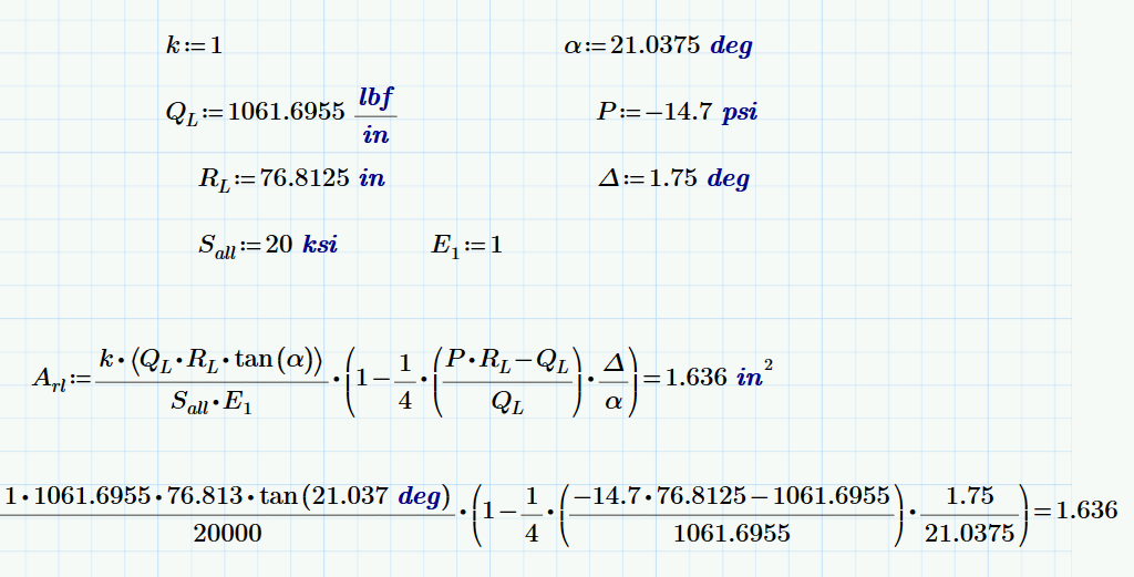

Hi Robert,
if  P*RL = 1129 psi * in, even QL must have the same units. The algebraic csum  is made between homogeneous quantities.
Bye

psi*in = lbf/in
September 13, 2016
I agree completely. But the applicant has considered the mass and not the strength.

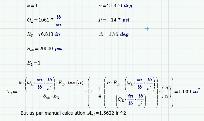

Dear Sir,
Thank you for your immediate reply.

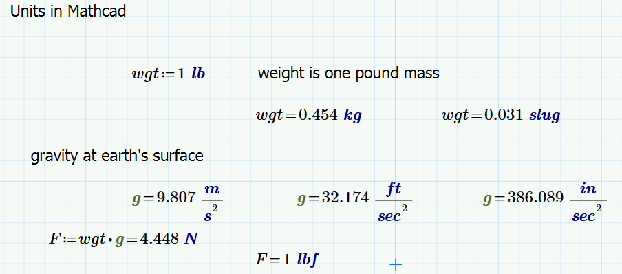

Robert;
You're getting confused by the way Mathcad handles units.
There is a difference between lb and lbf; lb is a mass unit (like slugs and kilograms.)  lbf is a force (like Newtons.)  Your equations need to be unit balanced if they're correct.  Now, you define Q as two terms, the first term has defined units:
So Q has units of lbf/in.
When you write lbs/in of circumference, you're specifying force per unit length.  To Mathcad, that's lbf/in, or N/m, or . . .
