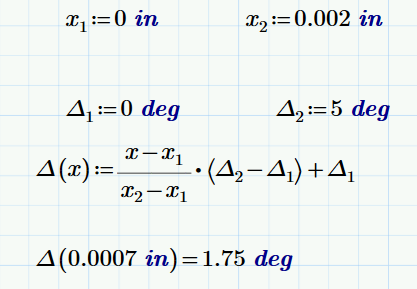

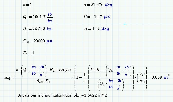

Please solve the calculation
alfa = 21.0375
please clarify, how two solve the first 2 calcualtion
23-Emerald I
September 13, 2016
The parenthesis in your equation is incorrect
ranto11-GarnetAuthor
11-Garnet
September 14, 2016

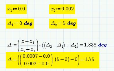

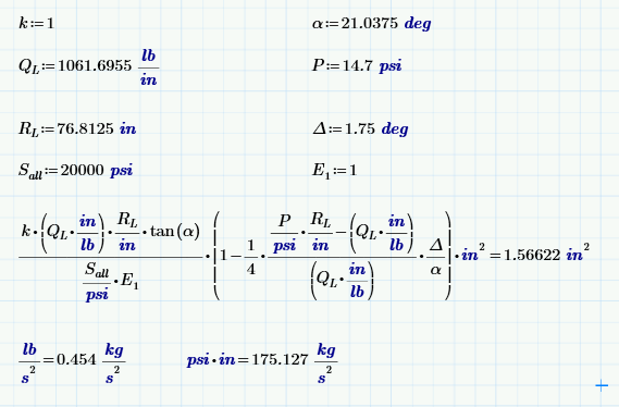

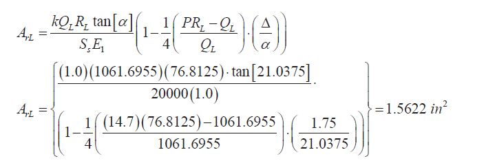

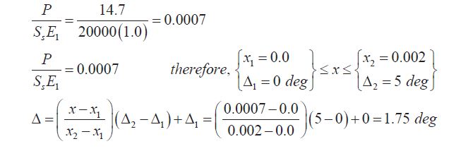

Dear Sir,
The equation is correct. see given below.
However based on the below calculation , the result was not came , while calculating manual the result was came.
while link the vale of "x" from below formula, then only the out put is incorrect. think some unit problem.
x1, x2, x - no unit as per the calculation P=14.7 psi, Ss:20000 pi, E :1.0 no unit.
Please clarify

Dear Sir,
Thank your for your immediate reply. however i will check the unit considereation.
regards
Robert
October 22, 2016

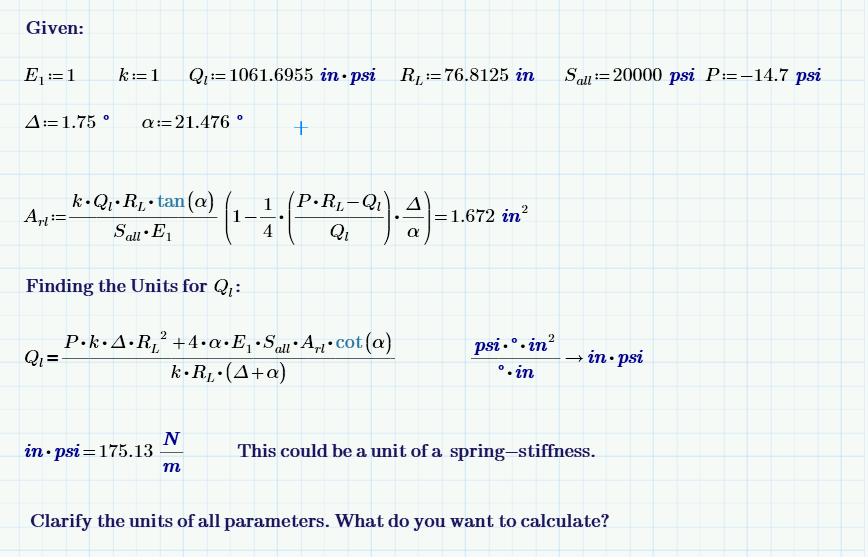

Robert,
look at this- hope it helps you.
