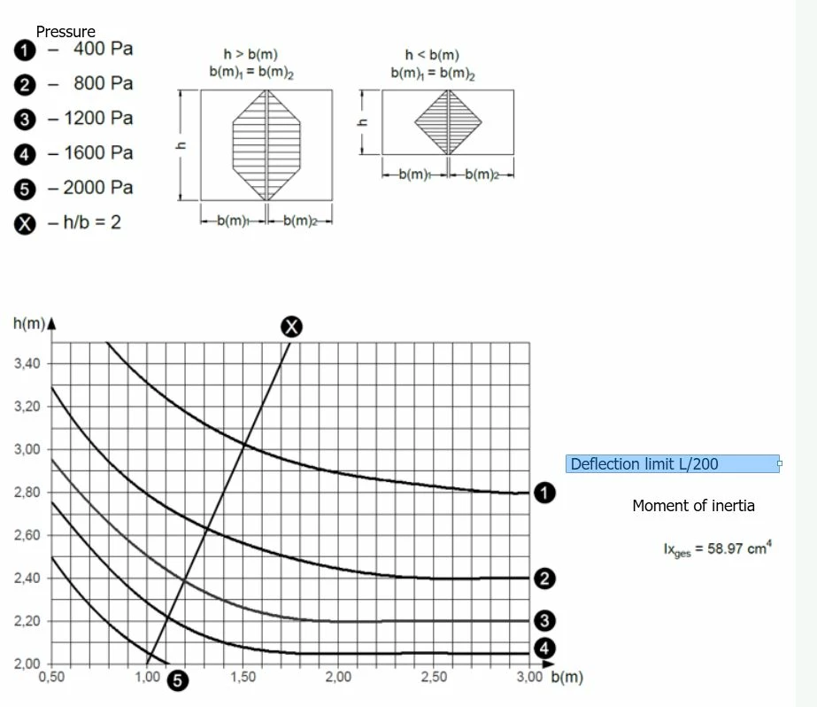

Good day.  Anyone could help me to make a tabulated graph similar to what I attached
Material is aluminum
Moment of inertia is given 58.97 cm^4
I am using  Prime 6.0
Design pressure is given
deflection criteria  L/200
Thank you.

If you provide an expression that relates h to b, probably with the other data you provide as (extra) parameters, we can create the plot.
December 17, 2020
Create please a matrix in Mathcad and use interpolation/
See please one picture from my book about this priblem

How are you calculating deflection?  Deflection depends on pressure, h, and b.  If we have that relationship we can develop this graph, but (Especially in Prime) the annotation will be a problem.
