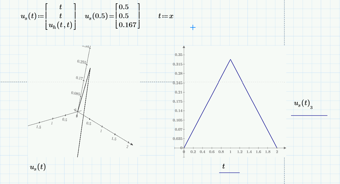

Plot 2D slice view of any angle
I have a 3d plot on an rectangle range within x-y,
I want to have a 2d slice view of the diagonal.
Is there a way to achieve this ?
There are several possibilities. Possibly the most straightforward is to create a special variant of your uh function that accepts only one parameter and returns the x, y co-ordinates on the diagonal and the value of uh, for those points. Then use CreateSpace to plot this function.

Hi, Stuart,
I am running the 3.0 version and using the educational license.
Is there a way to open your file with 3.0?
Or could you please screenshot your process of creating the variant function of uh?
Thank you for your help!
Shawn

You don't actually need CreateSpace to just plot the function ...
