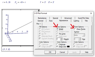

Is there anyway to plot a line in 3D graph tool? It seems like intrpolation doesn't work in 3D if all the points lie in a line. A patchy solution is to plot in a scatter point, but it indeed looks ugly. I would really appriciate if someone has any clever solution. I am attaching a Matchad 15 file for the refrence.

It still is a Scatter Plot (not a Surface Plot), but shows a line when you set the appearance correctly:
