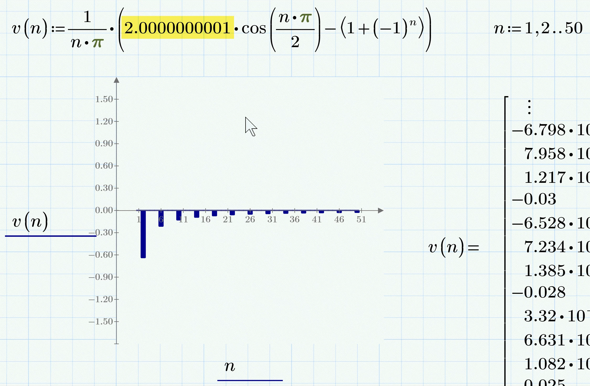

I agree and as I don't see any rational reason for this error I would call it a strange Prime bug.

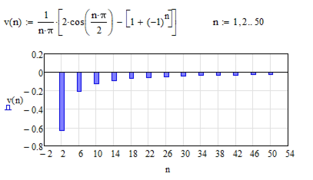

Prime seems not to like the fact, that only every fourth value is non-zero? Not sure what exactly causes that bug.
But I can confirm that it should work and it also does work OK in Mathcad 15

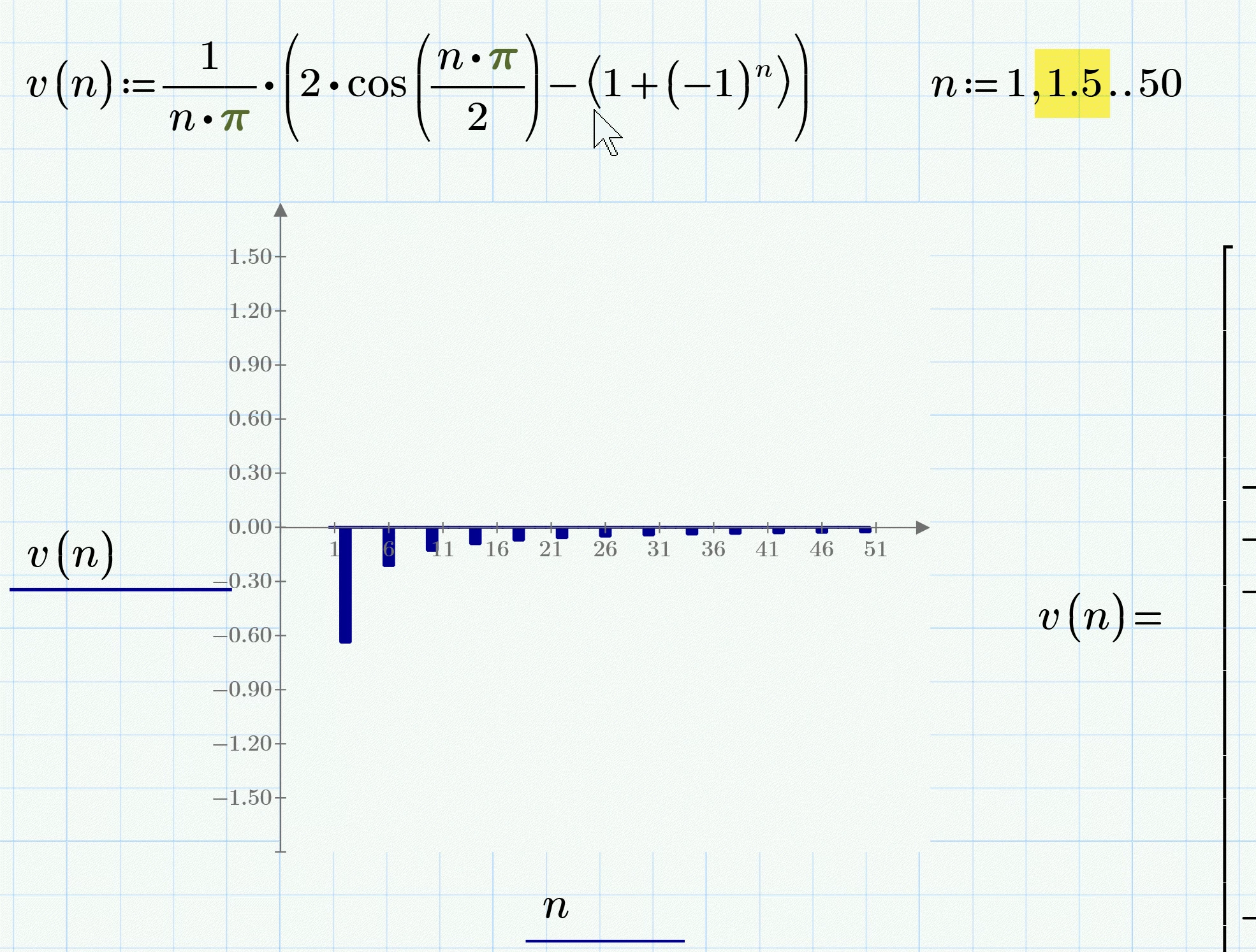

I found two possible workarounds to do it in Prime (not satisfactory but at least you get your plots):
1) change the factor 2 of the cosine to something close to 2
2) change the step width of your range n to 1,1.5 .. 50

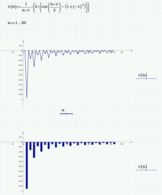

Interesting!  In Prime 3.0:
Going backwards?
Fred, your function v differs from the original function. The 2 is only a factor of the cosine.
