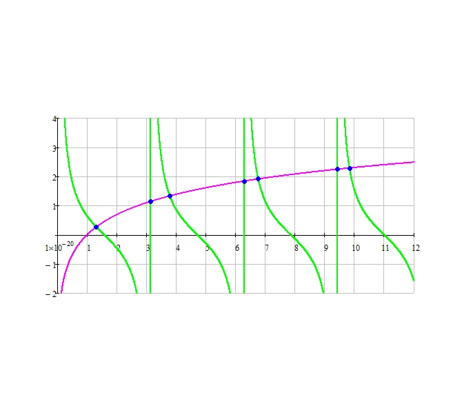

Hello, Everyone.
From the following :
Plot Intersection-points of the "green" and "pink" ?
    Thanks in advance for your time and help.
         Best Regards.

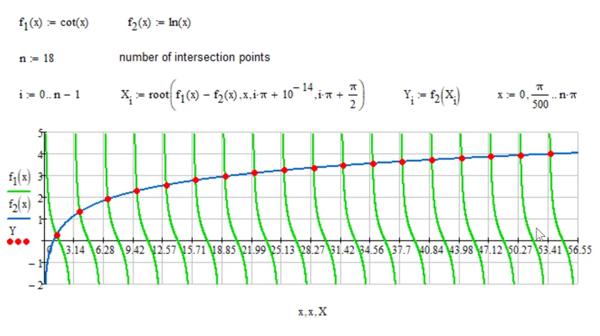

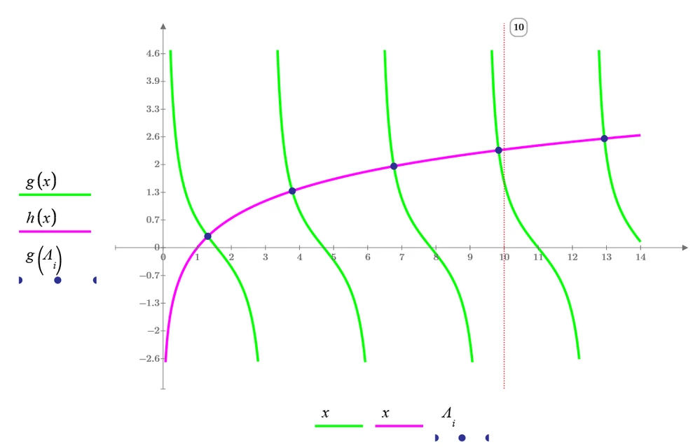

How about
ttokoro
Jan 6, 2023 11:45 PM UTC
Use root function. Prime 8 sheet attached.
t.t.
Werner_E25-Diamond IAnswer
Jan 7, 2023 2:08 AM UTC

 Many thanks for your time and help, Ttokoro, and Werner. And I would like to have also the intersection-points on the green vertical lines :
   Best Regards.
Jan 7, 2023 2:56 AM UTC

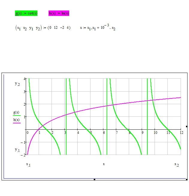

Why? The vertical lines are NOT part of the cotan graph! They are graphics errors and go away if you chose "draw" instead of "line" (see the sheet attached in my previous post).
These vertical lines are simply the asymptotes at multiples of pi. So if you really want to plot these points as well, simply evaluate ln(x) at every integer multiple of pi.
