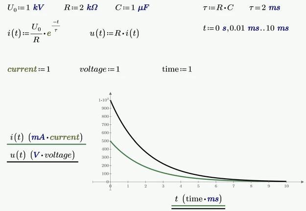

Quite a  nice idea, even though it would look a bit strange if you use real units in your plot (which you should), too.
P.S.: Missing a secondary y-axis! The chart component is not an option as it does not scale properly according to screen resolution (a problem with small 4K displays) and does not support units.
November 1, 2021
Thanks, Werner!
We say in Russia "Одна голова - хорошо, а полторы - лучше!". Половинка - это, конечно, моя голова. Я сразу не сообразил про единицы измерения!
