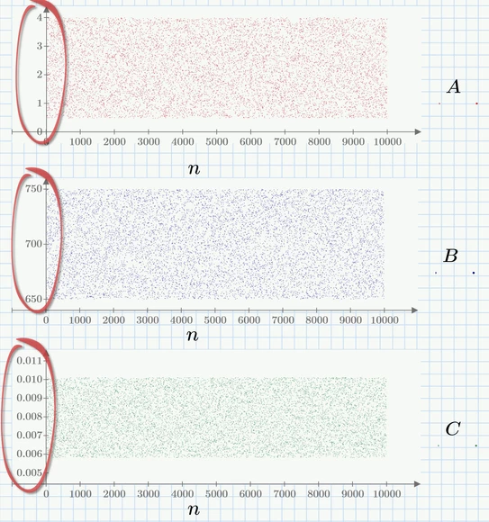

I am trying to use runif function however whatever I am plotting it looks the same. I am using ver 9.0

The plots look identical but if you look closely the axis values are different.

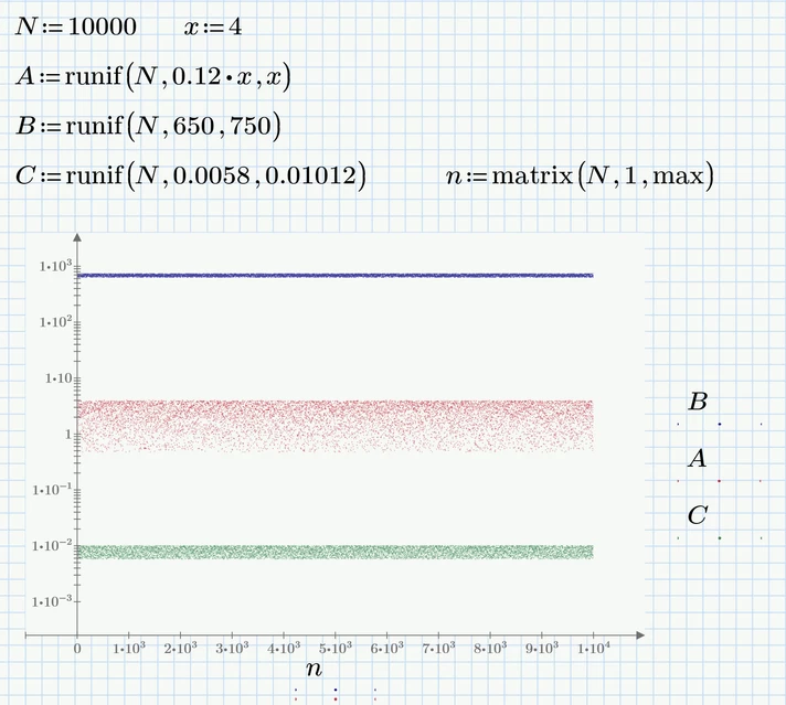

Use are asking about plotting, the name of your worksheet is "plot", but it does not show any attempt to plot anything!!!
As Terry already said it might be that you did not have noticed different scaling of the y.axis when you attempted to plot.
You will sure see a difference if you plot all three vectors in one single plot.
In the picture below I used a log scale  for the y-axis for better visualisation (otherwise you would hardly be able to distinguish between A and C)
Here separate plots using linear scaled y-axis - note the different scales!
BTW, Prime has a bad plot limitation and won't allow to set Trace Thickness  for traces with 5000 points or more. So we only have the choice to use thin lines or tiny points for the traces and I had chosen the latter.
Prime 9 sheet attached
