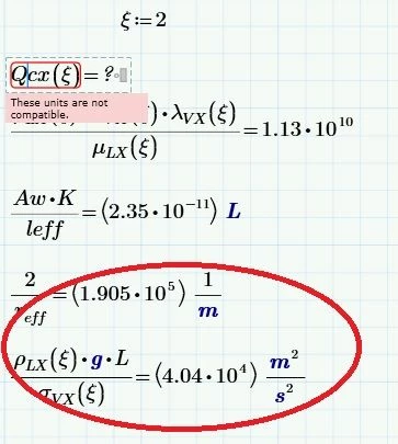

i have a function which can not plot, Qcx(x), ask me to replace complex values by real numbers.
If I delete last part in the bracket, it will pot Qcx2(x) correctly.
I attached my mathCAD file.

There is a problem with the units of measurement:
-MFra-
-MFra-21-Topaz IIAnswer
Mirui7-BedrockAuthor
7-Bedrock
Yes, it works.
