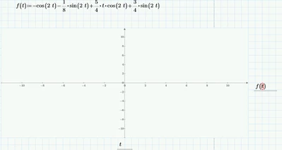

My question is: Why can't I plot the function f(t) by typing it in Y-axis area?
The only way to plot it is to type the equation value of the function itself.

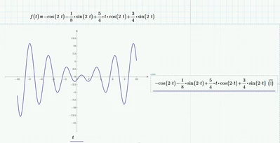

What I want is this:

Because you typed the t in the placeholder for the unit.
Place
f(t)
before the placeholder.
Same for the ordinate, be sure to set the t in the placeholder before the placeholder of the unit.

Sergey15-MoonstoneAuthor
Jan 7, 2026 9:57 AM UTC
I have got this. Thank you.
