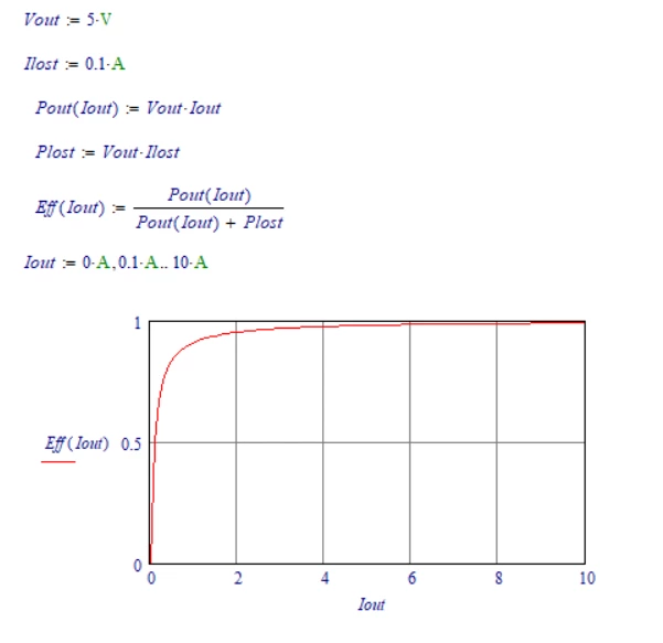

I am an electronics engineer who has just started with Mathcad v15. I work on a sheet which calculates total power dissipation in a power supply. I have many input variables which help me to get the desired information - total power dissipation (Ptot) and predicted efficiency (Eff). So far, the calculation sheet works well.
The struggle:
Now, I would like to vary some input parameters and see in a plot how total efficiency change. For example, I want a plot with Iout on the x-axis and Eff on the y-axis. I have already spent half a day by googling but could not come up with a solution. Could someone review the sheet and come with a proposal how to make a Eff vs Iout plot, please? I expect that I need to somehow turn my equation into a function (numerical vs symbolic engine).

Something like the attached perhaps.
Alan

Jip1-VisitorAuthor
Alan, this is great! What is the name of the magic you did with "k"? I understand how it works but I would like to study it more.
Thank you for your help and efforts.
k is a range variable. You can find out about them in the help facilities.
Alan

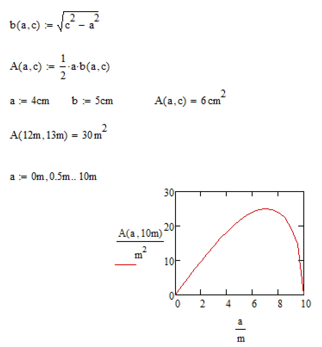

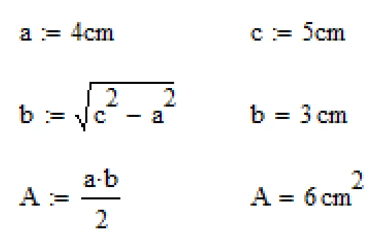

Here is a simple example. Instead of a static calculation of just one value
you turn the calculations into functions

23-Emerald I
Or, as Luc suggests, using functions
