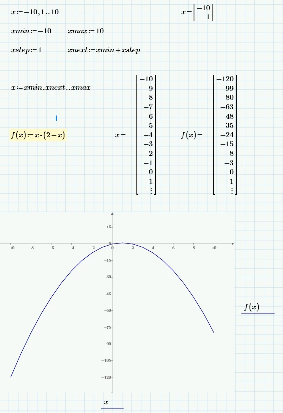

There is something wrong with the plot of the function (look at the attached file).
When "x" is defined from 0 to 10 the plot looks correct. But when I define "x" from -10 to 10 plot looks like a straight line.
Where did I make a mistake during the plot?

You should define x as -10, -9 ... 10 instead of -10, 1...10.
Edit: Alternatively just write it as -10 ... 10 if you want your step size to be 1.

Hi Sergey.
Your problem arises because you have (I think) used your intended step size in the range variable x's definition.
A range is defined as first_value,next_value..final_value. Mathcad uses the first and next values to calculate the step size.  You have x:=-10,1,10.  Consequently, Mathcad thinks you want x taking the values 10 and 1 (the next value after 1 would be 12, but the max range value you've give is 10).  What you want is x:= -10,-9..10.
Revised Mathcad Prime 8 worksheet attached.
Stuart

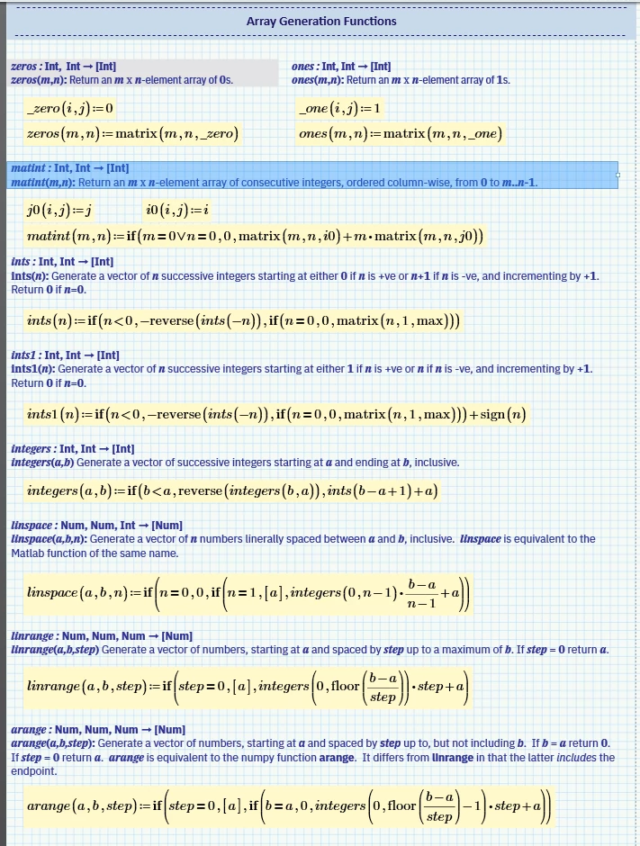

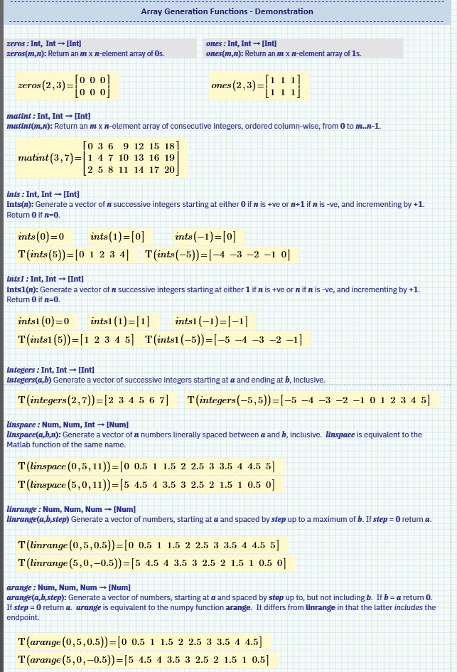

No worries, Sergey.   It's a common Mathcad error, particularly when people have some familiarity with languages that use steps instead of the next value in the sequence.
Sometimes, it's useful to have the choice, so I have a library of sequence generation functions in my default worksheet.

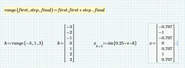

You could even define a function - range, say - that generates a range using the first, next .. final specification:
Mathcad Prime 7 worksheet attached - it should work in Mathcad Express 7 and Mathcad Prime/Express 8, as well.
