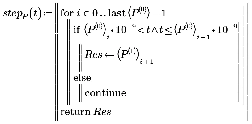

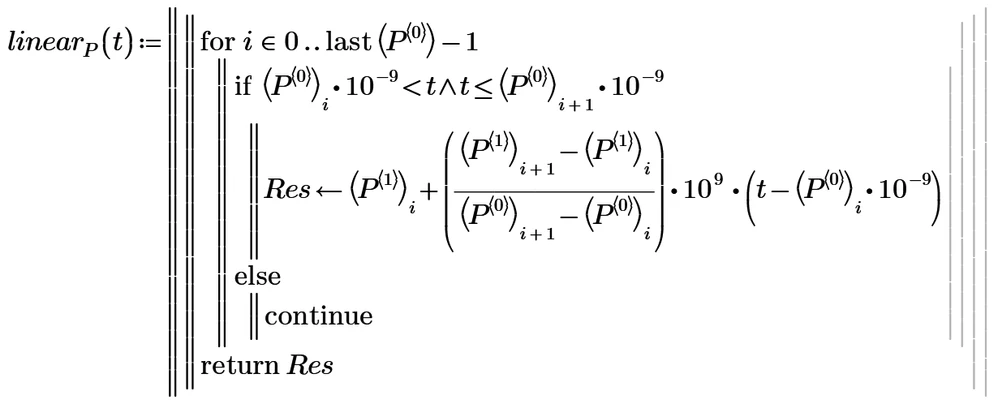

I can't do programming in Prime, so here's a solution without programming.
But I'm sure you can turn that into a program.
Success

Jacob_S1-VisitorAuthor
June 22, 2021
Thank you for the help

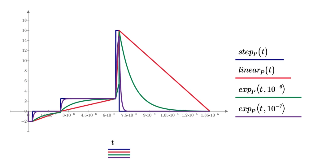

ttokoro
June 22, 2021
10^-6 and 10^-7 are tau of A*exp(-t/tau).
t.t.
June 22, 2021
Thank you for the details for realizing exponential  plot
ttokoro
June 22, 2021
t is in second unit such as 0.000000001 s.
t.t.
