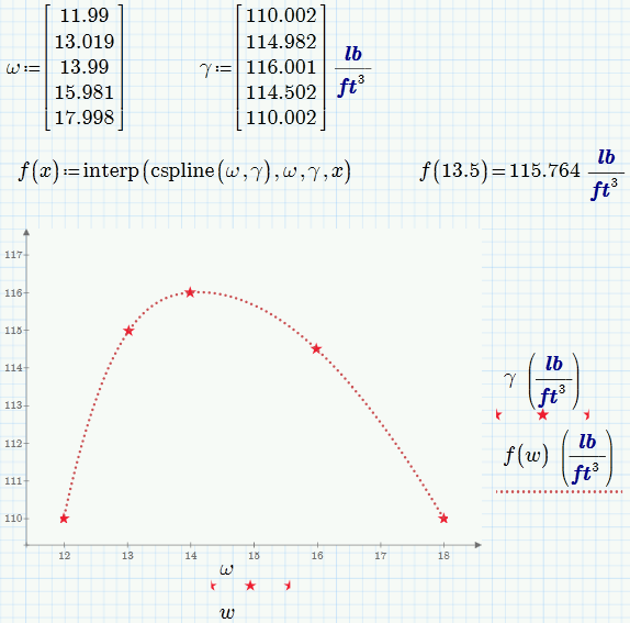

January 30, 2016
As Richard already said - use spline interpolation.
The attached file should help
WE

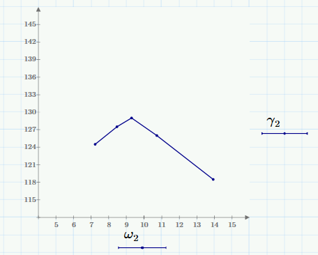

January 31, 2016
Hahaahaaaa Richard.....thanks for the help. I have developed my work using your example. I have attached my part with this reply. I have also shown a trend that comes up in excel with similar data......the first one seems to match but for the second one, it had some problem in mathcad as it showed a lower bump , so i had to omit the values that did not show a bump and matched that with excel. Also, my interpolation function is not on the tool bar so every time I needed this function, I had to call all functions and find from that. can you help me with that also......Thanks ( sorry again to request you during your dinner time again  )

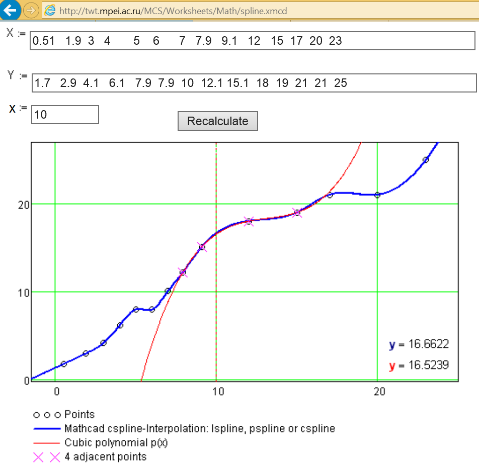

January 31, 2016
Try please a web sheet on Mathcad Server http://twt.mpei.ac.ru/MCS/Worksheets/Math/spline.xmcd

February 1, 2016
Your compaction curve from EXCEL is simply EXCEL's "smoothed curve" plot
Plotted without curve fit, Mathcad gives similar:

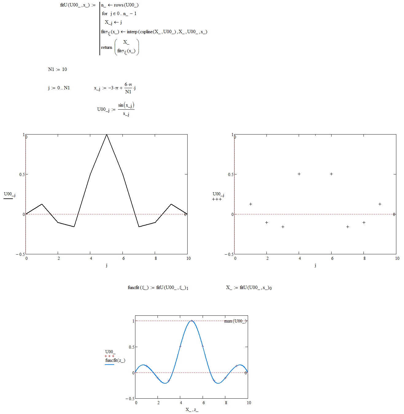

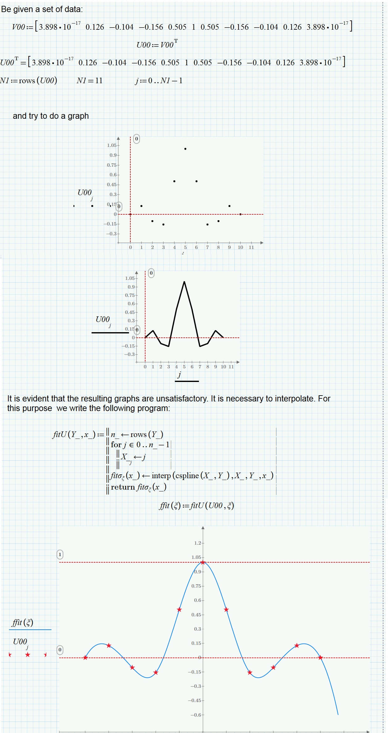

May 10, 2016
Hello Faisal, it could be useful the following procedure you need to adjust a graph consisting of a few points (ie a broken function) with a solid line ..
My solution for mathcad prime 3.1
But I am a little puzzled because the graph is prolonged beyond j = 11 point.
