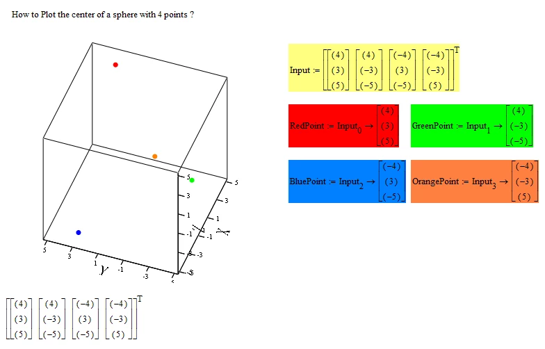

Plot the center of a sphere with 4 points ?
Hello Everyone.
From the following :
Thanks in advance for your time and help.
Best Regards.
Loi.

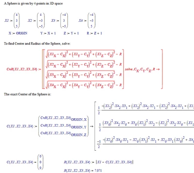

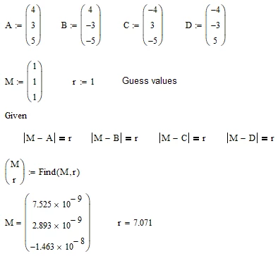

How about using a solve block?
In case of your data the centre of the sphere is exactly the origin.
You can increase the precision by setting something like CTOL:=10^-8

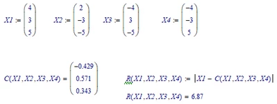

I greatly appreciate your time and help. I'm very happy with your help. My question would be the following : (just only changing the GreenPoint)
Thanks Again.
Loi.
Aug 22, 2022 9:10 PM UTC
Just type in the solve block and throw in the coordinates you are interested in.

Aug 22, 2022 8:32 PM UTC
Note that the exact expression of the center is large, in full it is:
With another set of points, you may get:

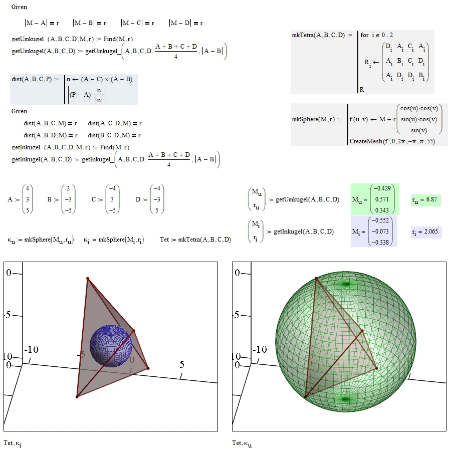

lvl10720-TurquoiseAuthor
20-Turquoise
Aug 22, 2022 9:06 PM UTC
Many, many thanks, Luc. And I still have a query about : center and radius of inscribed sphere.
Best Regards.
Loi.
