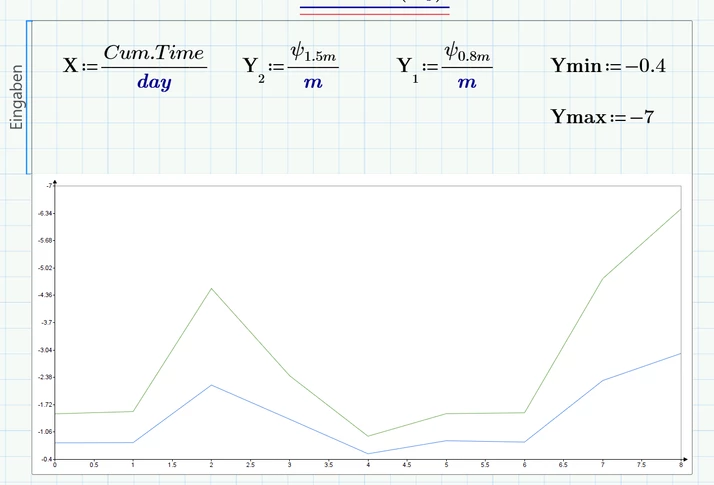

That's not possible in Prime, but in (real) Mathcad (15 and before) it is possible without problems by changing the axis limits accordingly.
You can do it in Prime but you would have to use the new chart component which was introduced with Prime 5. by defining Ymin and Ymax accordingly.
Unfortunately this chart component otherwise is just a piece of crap.

But the OP did not want to change the sign...
@LucMeekes wrote:
But the OP did not want to change the sign…
