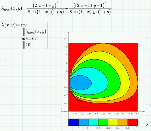

Prime does not support implicit plots, but you could use a contour plot.
You must type multiplication signs between a variable an a parenthesis as otherwise Prime assumes you are typing a function.

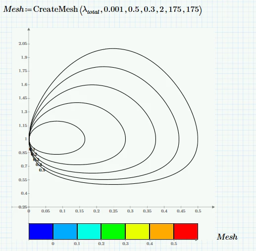

As a follow-on from Werner's, here's a CreateMesh option.  Using high enough mesh density the colors vanish (I assume because mathcad gets confused at the convergence point) but a possible advantage for you.  MF's solution works also but you'll get some gaps on the right end of the ellipse at times.
July 17, 2019
Normally the mesh density does not has much effect on the colors but in this case it obviusly has. Funny effect for a mesh size of 80 to 90. Alas, its Prime. Mathcad wasn't perfect in no way but we still had more way to infuence the plot (like number of iso lines, see the pic) but 3D-plots in Prime really suck.

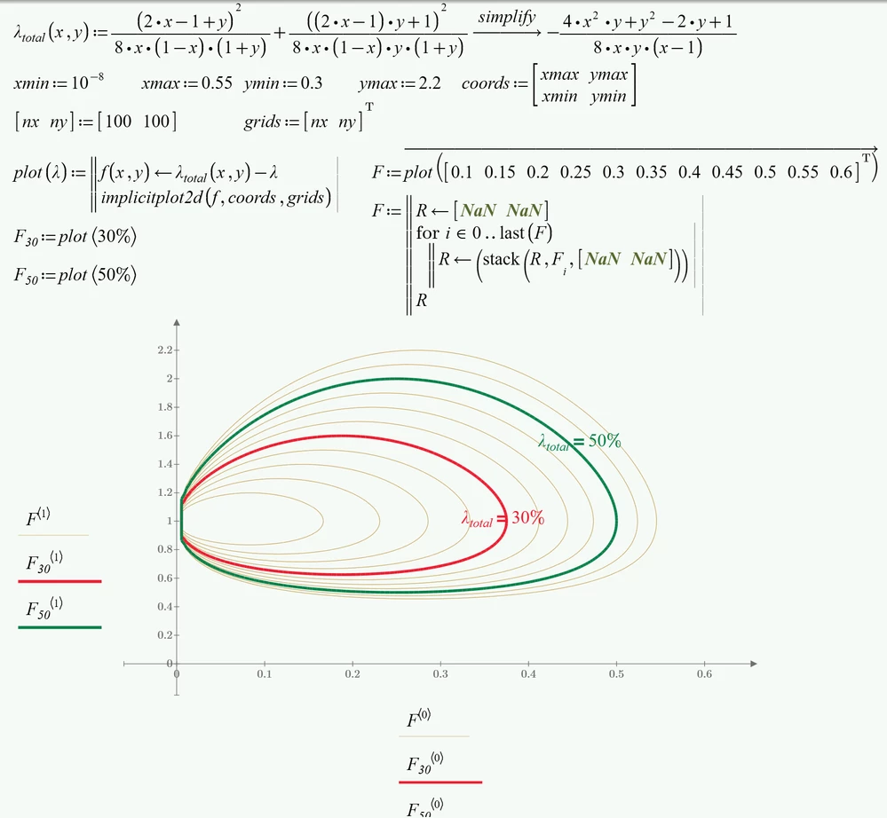

Who claims that Mathcad can't do implicit plots?
Thanks to Viacheslav N. Mezentsev even Prime can do it 😉

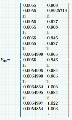

Can anyone explain how Mathcad is able to plot this implicit (ala Werner via Mezentsev) graph?  The data isn't sequential yet we get a smooth curve plotted.  (I had some crazy thoughts of fitting some b-splines to it, but hit some immediate snags given the format)
July 19, 2019
Looks like Viacheslav uses 1j instead of NaN to separate the various line segments.  So the "curve" you see consist just of a number of line segments which are not drawn in consecutive order.
Those segments are not in order but as a whole make up for the complete curve (which sometimes sure has some "holes". If you want to apply a fit you would first to have to get rid of the 1j's and sort the various line segments.
I never took the time to make a more intense look into his routine - just was impressed that its possible to do with reasonable speed.
