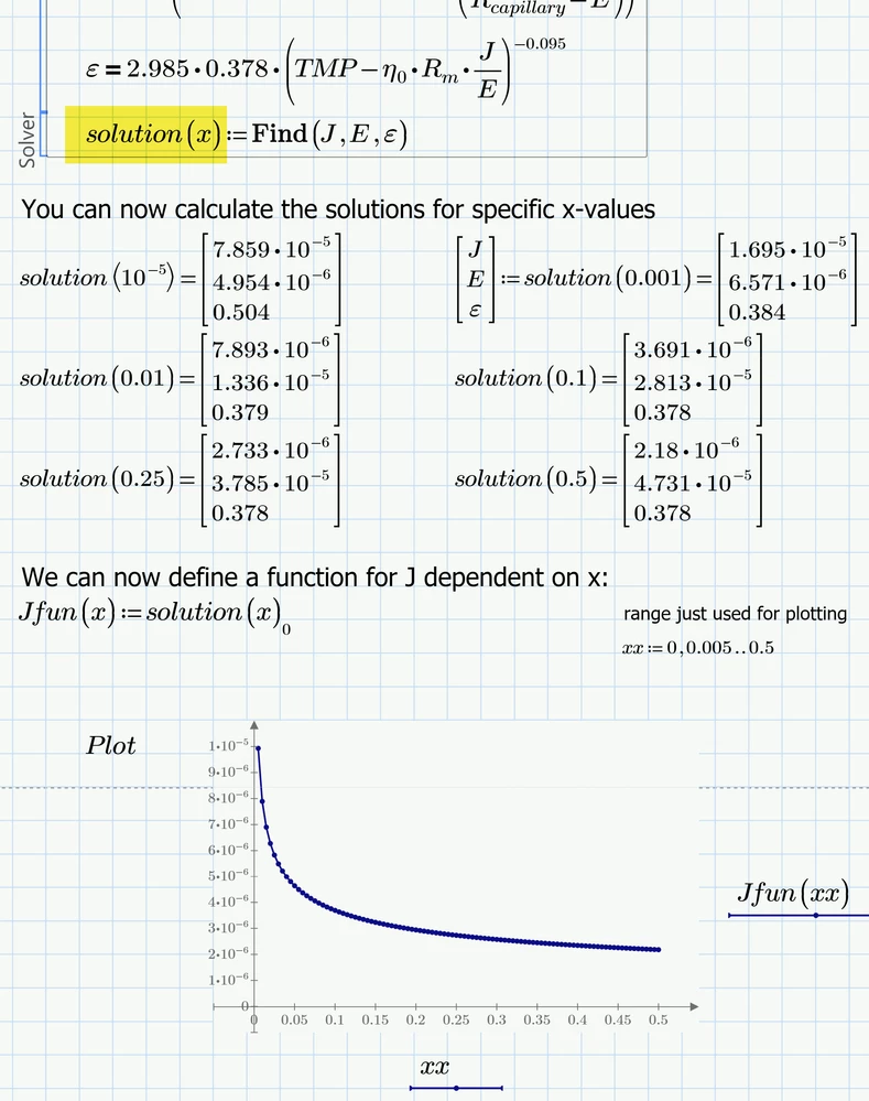

x hast a constant value of 0.001 and J has the constant value 0.00001695 calculated by the solve block.
So when you plot J over G you are asking Prime to plot the single point (0.0001 / 0.00001695) and that is what you get.
If you want to vary the value of x you have to setup the solve block as a function of x and then define a function for J.
The calculation may take some time as for each x-value (with the range for xx i used that's 101 values) the solve block has to be evaluated.
You may consider setting CTOL to a more sensible larger value - IMHO 10^-10 may be too small.

Thank you very much, Werner.
It works perfectly for the plot. I can now also plot epsilon as a function of x, using the way you showed me.

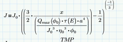

Just one related question I was trying to replace this equation in the constraint part of the solver (first equation for J)

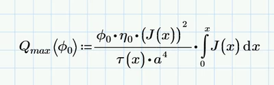

with the equation below which I can't rewrite in a form of J(x)=...as J(x) is found in both the numerator as a form of J(X)^2 and in the integral J(x)dx form 0 to x. Is there a way to do this which you can help me. I even can't start it. I will help if you/or any other kind person have any idea.
Kind regards,
Lenin
Thats a complete change as now (in the solve block) J is not a  constant variable but a function.
I don't think that Prime can solve integral equations.
