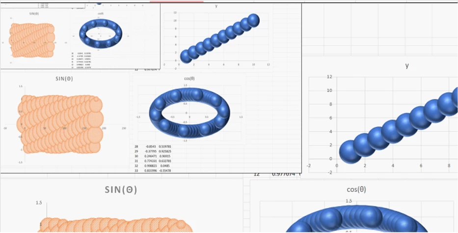

ttokoro
Apr 8, 2024 11:31 PM UTC
Plotting graph Prime 9 EXCEL component to show the Camera function image of EXCEL.
