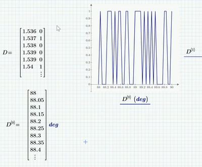

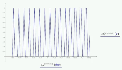

I am trying to make a plot of the dependent variable digital data (zeros and ones) in a column of a matrix vs another column (independent variable - x axis) that has units of degrees.  If I add volts units to the dependent variable it plots fine but as soon as I eliminate the units then the error "The values in the axes placeholders must be real numbers or expressions. Make sure the values are of the same type in both placeholders" is returned.
The plot with the errors has the Y variable as a column of the matrix that is unitless.  The one that works has been fudged by adding units to that column.

I'm sorry.  I have solved it.  My routine was leaving a few rows at the end of the matrix with units.  This led to mixed units.  It is fixed now.  Thank you!

We would have to see the worksheet itself not just a picture to be of help, I guess.
Using some random test data all works as expected
February 17, 2022
0 is fine as a unitless number because it has no effect on any number with units. You'll get an error that says something about imaginary numbers (like the one you got) when there's a mixture of units in the array.

Looking at the picture which was posted it should be clear that @ptc-4932387  is using Prime.
And Prime is just happy with a mixture of units in an array.

Can you show us what D is?  Does D already have units? Did you create D by augmentation?

Mixed units in a row should be no problem as long as every column you use for plotting is unit consistent.
