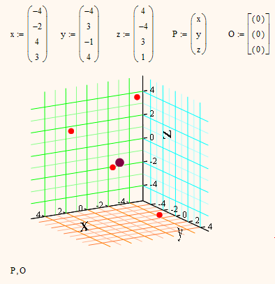

We don't see what you are trying and which version you use (I am assuming real Mathcad).
The problem may be that you need a special structure to plot your points. This has to be a 3 x 1 vector whose elements are the vectors of x-, y- and z-coordinates of the points:
Regards
Werner
PS: Sometimes you will get an error and then it helps, to set first "vectorfield plot" and then back to "scatter plot"/""data points".
