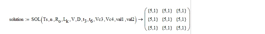

I've already look a lot in the forum, but I just couldn't find an answer to this, I guess, simple question. I have a matrix like this:
I want to extract the data from the fifth line of all the {5,1} and throw it in a different array. I have tried using Ctrl+6, but with no success. The second point is that I want, then, to create a 3D plot with the results. Anyone has a hint on how to accomplish these two matters ?

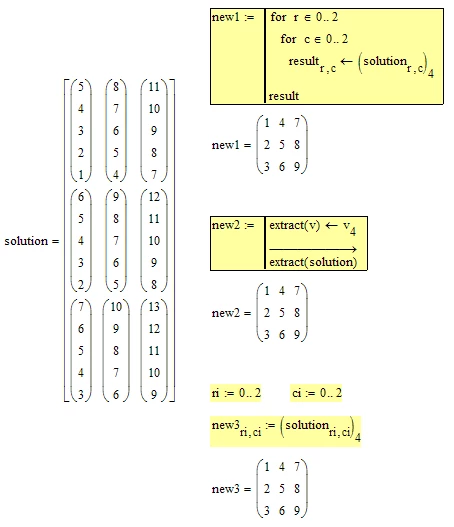

Here are three different appraoches which should do the job
According the 3D plot I am not sure what you want to see. A 3D plot of just a 3x3 matrix?
For future questions its better if you attach your Mathcad sheet - you may have to zip it before you can attach it here.

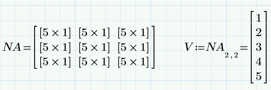

You have a nested array?
ricasc1-VisitorAuthor
Exactly, any idea on how to succed ?

Werner_E25-Diamond IAnswer

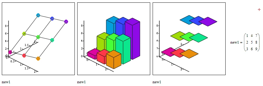

Ad 3D plot - something like this?
