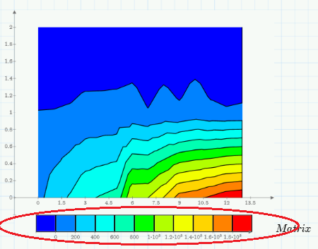

I would like to make a contour plot of function of one variable(pressure distribution in one dimension element, at fixed time moment). I wish it would look more or less, like Mathcad prime contour plot legend.
Every attempt fails with "Cannot interpolate 3-D scatter data. These points all lie in a line"
Thank you for any help.

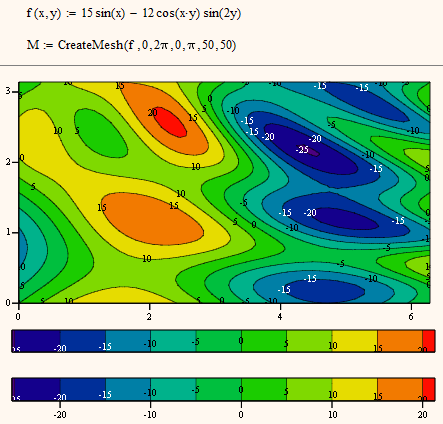

Are you looking for something like this?
23-Emerald V

Nov 1, 2014 8:33 AM UTC
You are probably right guessing what Micheal needs.
I was thinking that he just wants to add a color legend and was trying with a function of one variable to achieve this goal.
BTW, thats the collapsed region in my sheet showing two approaches for a legend (the second being the preferred one):
