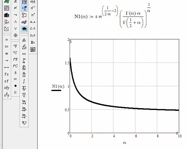

April 13, 2020
M15,

Hello -MFra-,
Thanks a lot.
I have no problem with MathCad 15.
Prime is the problem. Please see the attached Prime file.

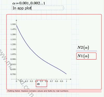

23-Emerald I
April 13, 2020
I have only Express, so the  G function is not available to me, but this is how to plot inside mathcad.  N2 function plots just fine.
